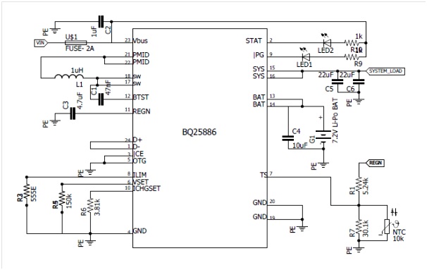

I am using BQ25886 in standalone mode and not using OTG feature. I have some questions and issues with it, kindly suggest with the solutions,
1)  If i do not connect battery, I am not getting any voltage across SYS pin with input supply of 5V, 2 amp source,
2) I have set Vset to 8.4V (Rset=150k), But voltage at BAT remains same with battery voltage 6.5V. Also the STAT LED is ON.
3) Since I am not using USB OTG, I have shorted D+ and D- with 200 ohms resistor (not updated in schematic). and OTG is connected to ground.
4) ILIM is set to 2A using 555ohms resistor and Ichgset to 1A using 3.81k. (Also 10uF capacitor is connected to PMID w. r. t ground which is not updated in schematic)
As specified in datasheet, I do hope all connections seems good, but dont know the reason why it is not working. Please reply if any design issue in the circuit.
Please find the circuit ,
  • Dear Vishwanath,
    We recommend 10 uF minimum on PMID. Can you please capture waveforms of VBUS, BAT, SYS, and SW when you are having problems?

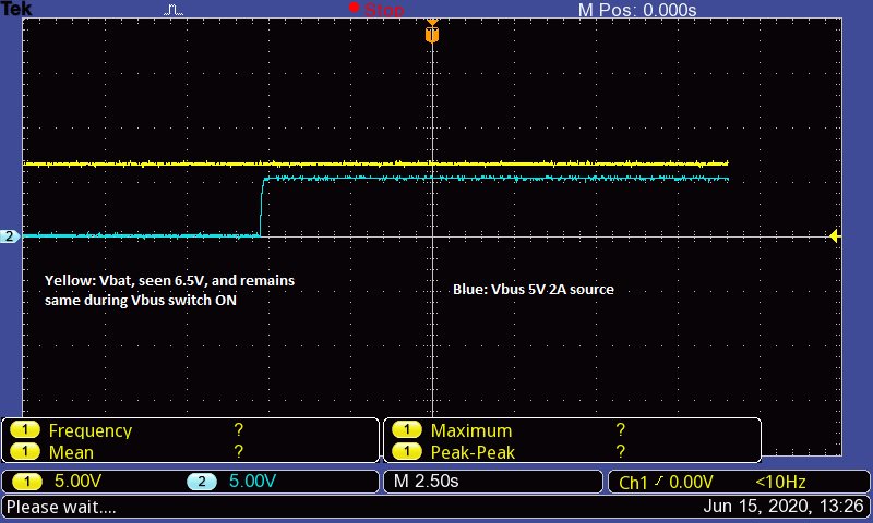

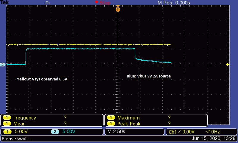

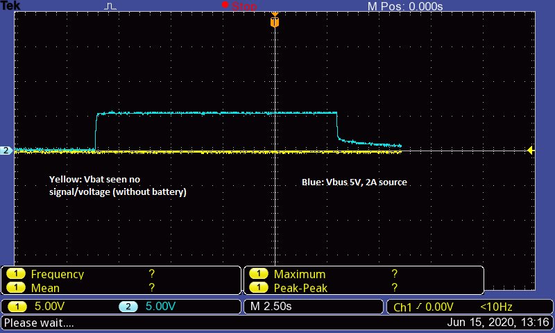

  • Hi Mike Emanuel,
    I will capture and share the waveforms,
    As per my analysis and observation, Vbus is 5.2V, BAT is 6.7V (battery voltage with battery and 0V without battery), SYS=6.7V (with battery connected and 0V without battery), SW is 8.7V (with 0.5V ripple)

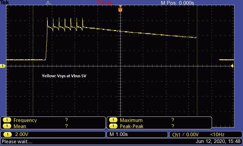

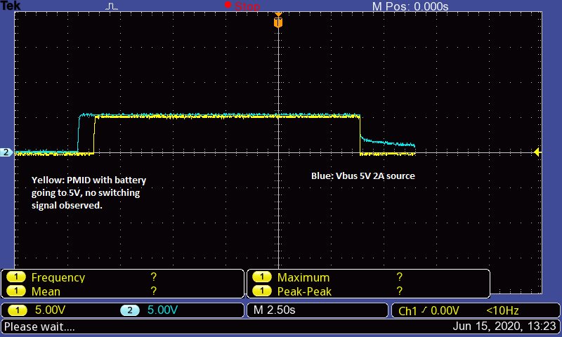

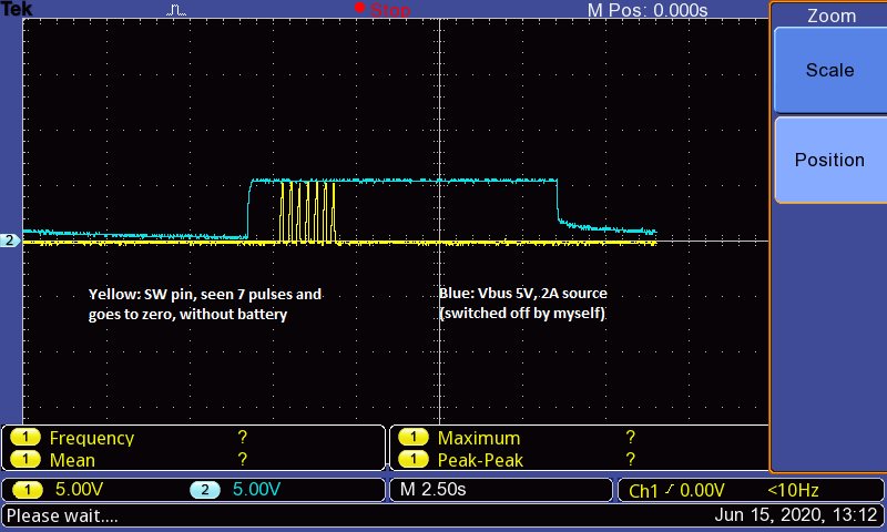

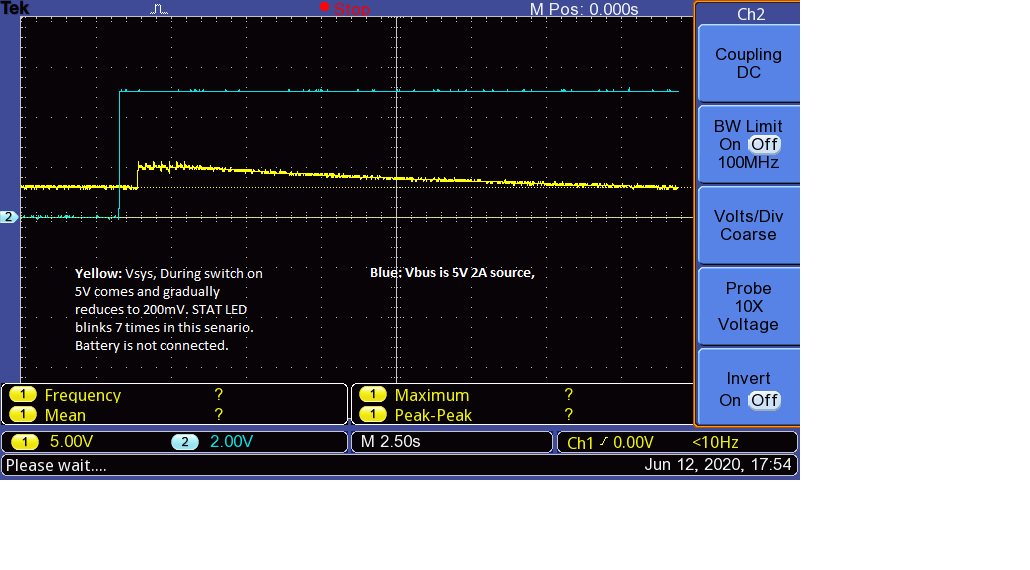

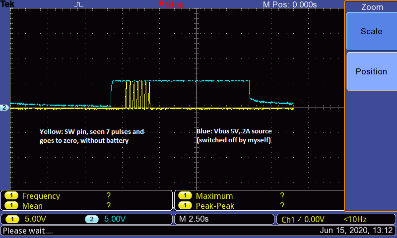

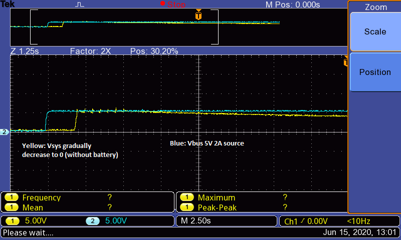

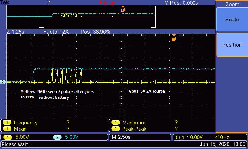

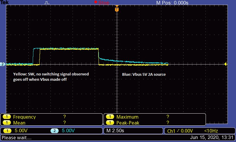

  • Hi Michael Emanuel,
    Since We do not have 4 channel DSO, I could not able to take all waveforms as you mentioned. Please go through below waveform of Vsys and Vbus input voltage.
    Input source is 5V 2A source, when connected without battery, 7 pulses can be seen in Vsys and gradually it decreases to 200mV. I will try to give the remaining waveforms 2 at a time, please co-operate.
    Also need answers for the following questions..
    1) I am not using OTG and it is grounded. And D+, D- is shorted with 200ohms resistor, How does it works when ILIM having 555 ohms resistor? Which current selection will be prioritized?
    2) As datasheet specifies, is it entering to HIZ mode? Since STAT LEd blinks 7 times and goes off?
    Please clarify and suggest me to make it work..

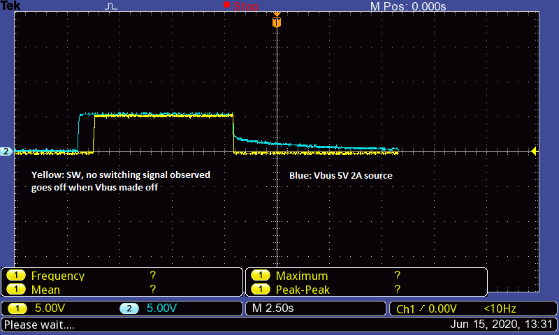

    Please find the waveform below,
    thanks,
    Vishwanath G

  • Dear Vishwanath,
    Can you confirm that your are measuring the pin VBUS on the schematic and not that VIN label? In addition, can you measure the impedance from the adapter to the VBUS pin? I am concerned that the voltage at VBUS is different than the VIN label.
    Mike Emanuel

  • Dear Emanuel,
    I am measuring at Vbus only, near decoupling capacitor C2 end (measuring 5.1V). And the impedance from adapter to Vbus is 0.2 ohms, seems very less and negligible voltage drop.
    The adapter is not having D+ and D- pins, Load testing is done for the adapter up to 2.5 amps, no issues observed.
    PG LED also goes off when adapter is powered ON and STAT LED comes ON during power ON with battery. But voltage shows battery voltage.
    When battery is not connected and powered ON, PG LED glows continuously and STAT LED blinks for 7 times and goes off. Vsys reaches to 5V and gradually decreases to 200mV. Vbat is 0V.
    Tried by removing 200 ohms between D+ and D- (kept open), no positive result, included 5 ohms resistor for Vsys before 44 uF capacitor, No positive result, ILIM and ICHGSET resistor limited to lower input and charging current respectively, no positive result,

  • Vishwanath,
    Do you have a system load and if so how much?
    Can you please probe the REGN, STAT, and /PG voltages? I need to verify REGN is on.
    Last, did you ever try to add the PMID capacitance? This is necessary for operation of the converter, yet there is no capacitance in your schematic. Please add this and let me know if anything changes.
    Mike Emanuel

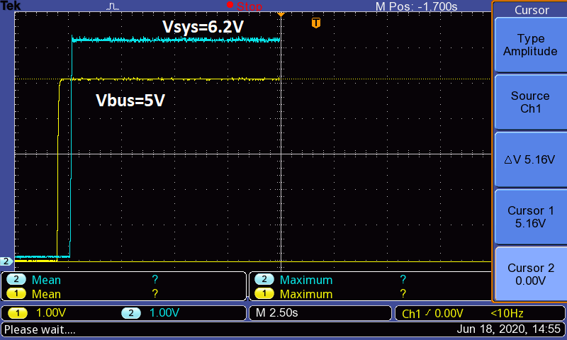

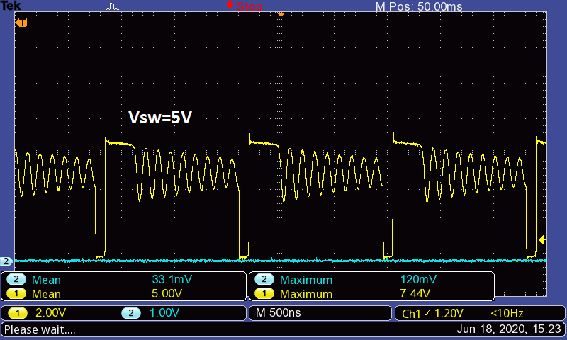

  • Dear Mike,
    As in told, in schematic PMID cap is not updated. But I have put 10uF capacitor for PMID. Also tested with 20uF, no positive result.
    Without battery connected, If I turn on the power, REGN is measuring 0V, means LDO not getting on. /PG LED goes high in this case. Vsys reads 0V. STAT LED blinks 7 times and goes off permanently.
    With Battery connected and turned on the power, STAT LED turns on continuously, but Vbat is same as battery voltage around 6.5V. Vsys reads same of battery voltage 6.5V.
    I have one more observation, If I remove 4.7uF REGN capacitor, (without battery),  REGN=5V,  Vsys=6.2V, /PG LED: ON, STAT LED: OFF.
    If i connect the battery to the above configuration, Vbat is same as battery voltage i, e, 6.5V.

  • Dear Vishwanath,
    Just to be clear, the PMID capacitor is not optional. The fact that REGN is not turning on is indicating a problem with your input source. Can you please verify that your input source is valid? Has the fuse been blown?
    Mike Emanuel

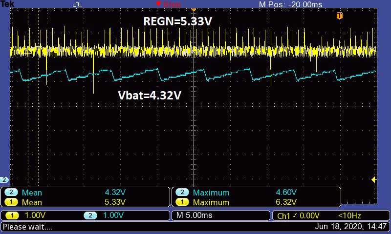

  • Dear Mike,

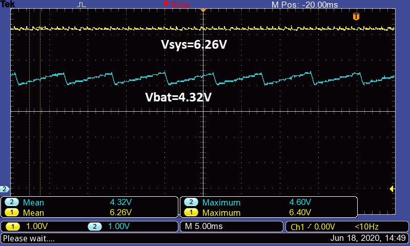

    Please refer the below experiments,
    >Without Battery
    a) 4.7uF of REGN is removed, then REGN came ON and found 5.3V, Vsys=6.2V, Vbat=4.32V. (IC is configured to give Vbat=8.4V, Vset=150kohms.)
    if I connect battery (7.4V 2S LIPO battery having voltage of 6.5V) then REGN=5.33V, Vbat=6.5V, ICHGSET=400mV, ILIM=0.00V and Vsys=6.5V.

  • Dear Vishwanath,
    The schematic is correct, provided the PMID capacitance is added.
    Are you sure that when you connect the REGN cap it is connected properly? Please make sure the cap is not being shorted via the connection method. Adding the REGN cap correctly will not make it short to ground. Is there an alternate way to connect this capacitor to ensure its correct connection?
    You say these waveforms have no battery, what is the status of the thermistor?
    Can you please detail your battery connection? The sawtooth waveform of the battery at 4.32 V does not look right.
    As for the D+/D- pins, shorting the pins indicates the adapter is a DCP and can support 3 A. Your adapter cannot support 3 A however. You need to properly connect the D+/D- pins for your adapter in accordance with the BC1.2 specification. Otherwise, the part will try to pull more than 2 A off the input and blow your fuse and/or begin to crash the adapter.

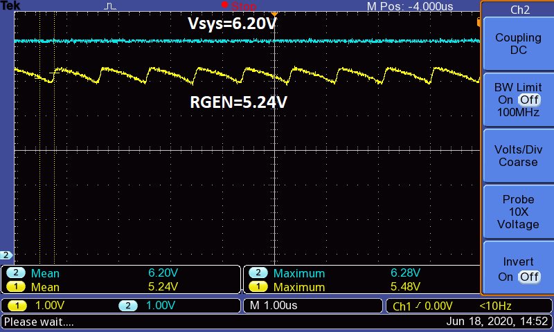

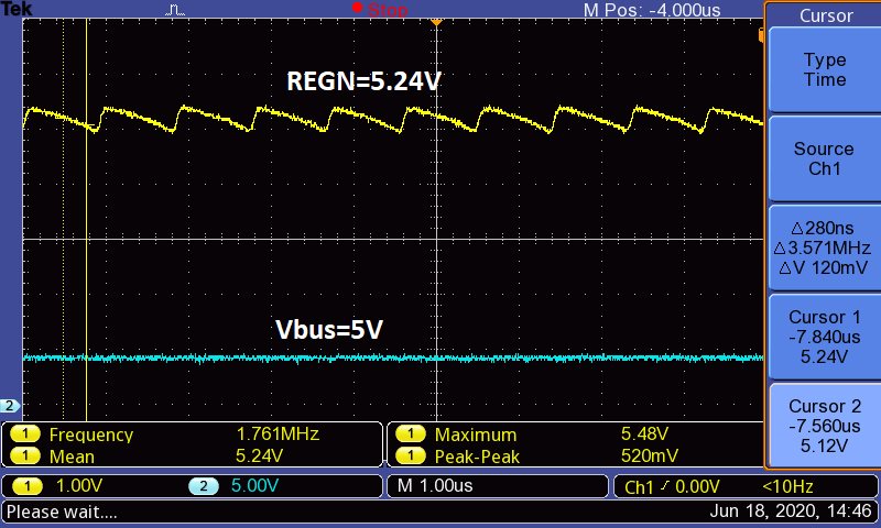

  • Hi Mike,
    Once the supply is powered on, the |PG LED turns on and goes off, I hope the poor source qualification is working fine, (following STATUS LED is coming ON),
    RGEN also has mean voltage of 5.24V looks like saw tooth, is this not right?
    For your information the meanwell supply we are using, is 5V and 5A source which is tested and evaluated.
    Vishwanath G
  • Dear Vishwanath,
    At this point I would recommend ordering an EVM. Please attempt to charge with the EVM and see if SYS is regulated. Once the operation of the IC has been confirmed, please swap it with the IC on your board and attempt to verify the operation from the EVM. Please let me know what results you obtain.

  • Hi Mike,
    Finally we found out our design issue with this, We modified, and the circuit is working, evaluation under process.
    thanks for your co-operation,
    Vishwanath G
  • Hello Vishwanath,
    May I ask what's your design issue of a schematic? I thought i met the same problem as you.
    Thanks for your information in advance.
    wenting
    Actually while updating the new schematic, PG and ILIM pins were interchanged, And above shown schematic is old one which is correct.
    Now the device is working well, Also we need to take care of supply input, for example, I have tested with 5V 5 Amp source in which charging current limited for 1A meets the requirement,
    If we test with 5V 2Amp source, still the device works but the charging current is only 0.45 amps and Vbus drops from 5V to 4.6V as specified in datasheet.,
    Do not overload REGN, All recommended values and PCB layout to be followed, then it works,
