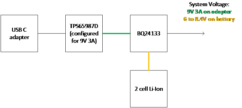

Do you have an integrated solution for charging two lithium ion batteries via USB C?  I didn’t immediately see one, but wondering if something like below would work:
Or maybe there is a better solution available?
