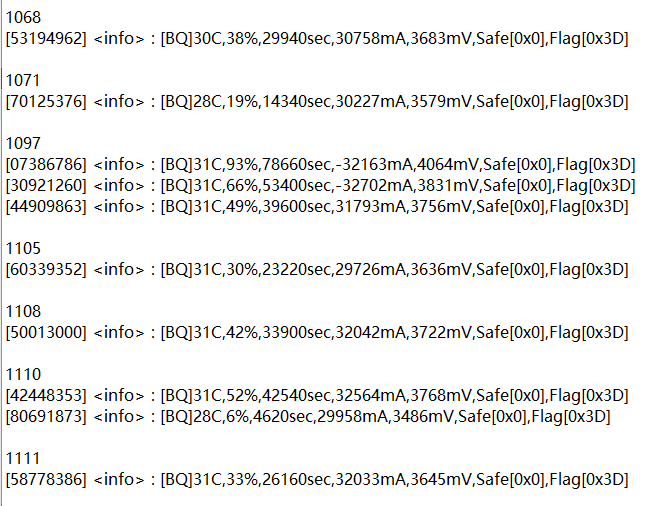

BQ27542-G1: Occasionally read out the abnormal current from BQ27542
Part Number: BQ27542-G1
Dear sir,
The following is a log summary of the occasional abnormality of seven batteries in the machine.
 It can be seen that the current above 30000mA will be read, and sometimes it is still positive (the actual working state of the machine is discharged, it should be negative, and the current The normal range of the value should be in the range of -70~-170mA).
Can you comments on this issue?
