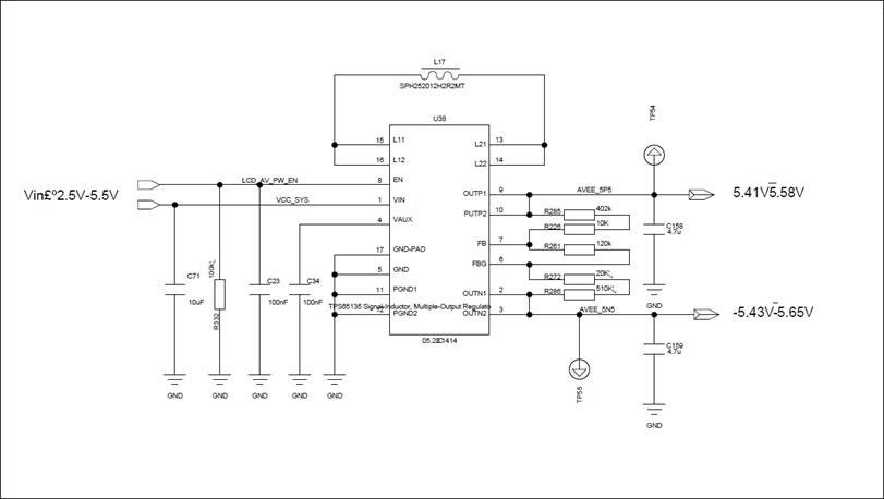

Dear Sir,
How to measure efficiency of TPS65135 for below spec.
please let me know calculation method.
Buck-Boost mode
Vin : 5V
VCC_SYS : 5.0V / 56mA
Vout : 11V
AVEE_5P5(Output_P) : +5.5V / 9.8mA
AVEE_5N5(Output_N) : -5.5V / 9.8mA

Hello Dexter:
Efficiency of converter is output power delivered / input power. Based on the description in your post, input power = 5V *10mA = 0.28W, Output power = 11V*9.8mA = 0.1078W.
Efficiency = (0.1078/0.28) * 100 = 38.5%
