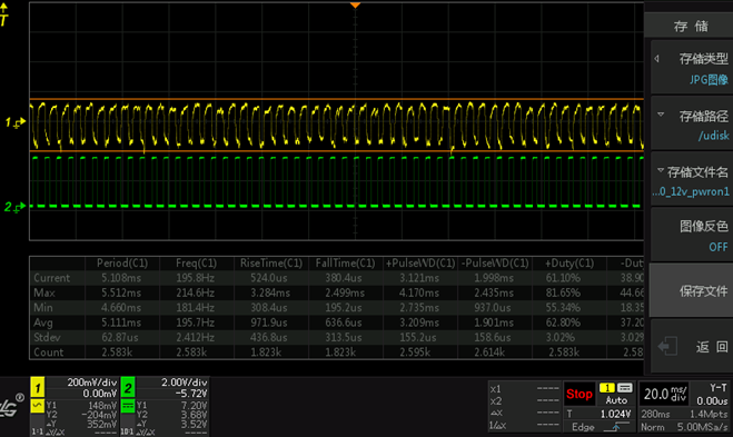

The frequency that 61194 supports PWM is 100HZ~20kHZ. What is the recommended frequency for use in the car display? At present, customer use 200Hz, measuring the power supply input power ripple is large--350mV, as shown below. yellow is VIN_12V voltage, green is PWM signal.

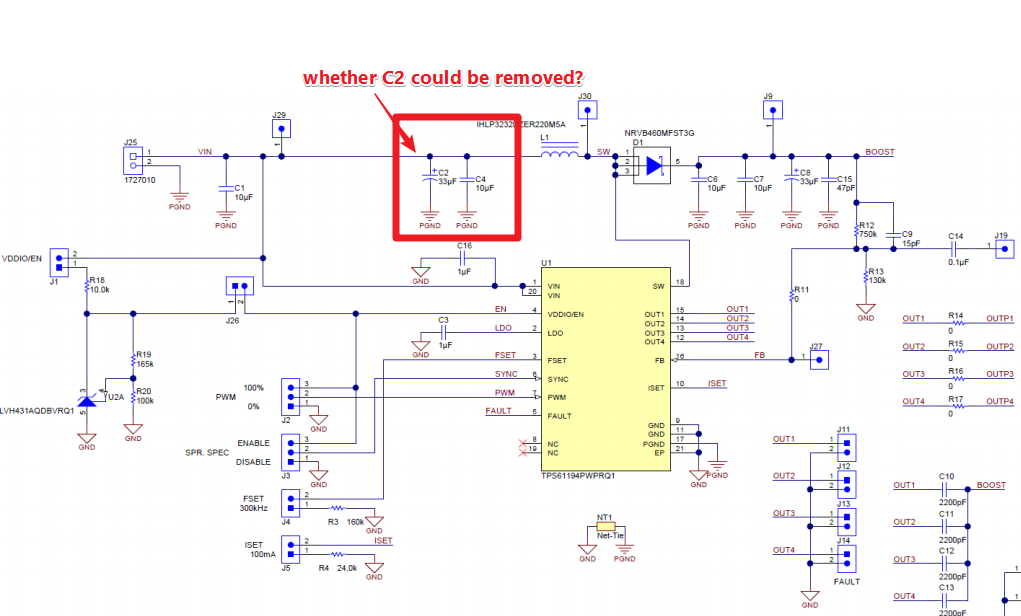

In the reference design, it is recommended to use ceramic + electrolytic capacitors for the input and output terminals. What is the main function of the 33UF electrolytic capacitors here? Can it be eliminated or replaced with ceramic capacitors when space is limited?
    It's OK if 200Hz generates no noise.
    As long as the 2 × VIN MAX or more voltage rating and the value of capacitor under this frequency(Tab 2 in the datasheet) are met, it's OK to use ceramic capacitors.

    Which frequency is the most commonly used?
  • Hi Amelie,
    If there is no noise, you can use 200 Hz to obtain high dimming ratio.(The lower PWM frequency, the higher dimming ratio).
    However, if there is noise at low PWM frequency. You can raise your PWM frequency and the final value is up to actual situation.
  •     Hi Charles,
                   Tab 2 in the datasheet,At 400KHZ switching frequency, it is recommended to use it 2x10(cer.)+33(electr.). Can it be replaced by a 53UF ceramic capacitor?
  • Hi sir,
    You need to consider the derating of ceramic capacitor with voltage and I suggest the minimum value of output capacitor should at least be 33uF considering the derating of ceramic capacitor. And you also need to verify the loop stability after replacing the capacitor.
