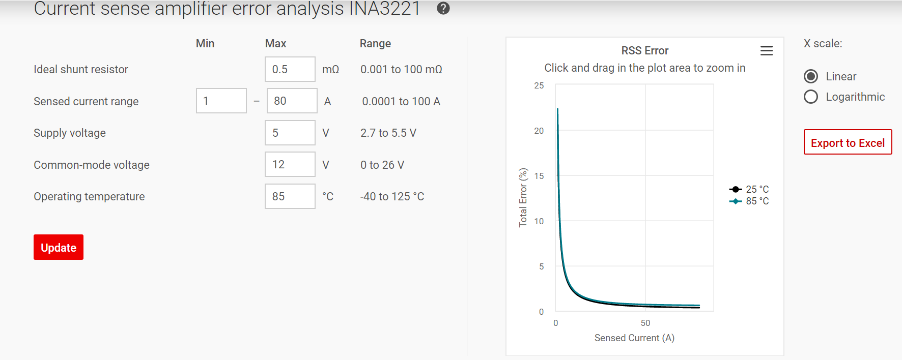

    As an example, the customer could choose a 500 microohm shunt, but this would still dissipate 3.2 W in the shunt at maximum current. Is that an acceptable amount of heat for their application? At 80 A, the generated voltage read by the ADC at the inputs would be 40 mV, which is well above the offset voltage, and would keep the total error generated below 2% down to around 10 A, where the offset will begin to dominate the measurement. See the output from the INA error tool below(you can find this on the INA3221 home page):
    You can use this tool to explore other various values of shunts, but we need to better understand the specs of the customer's system before we can make a rigid recommendation of what value of shunt to use here.
