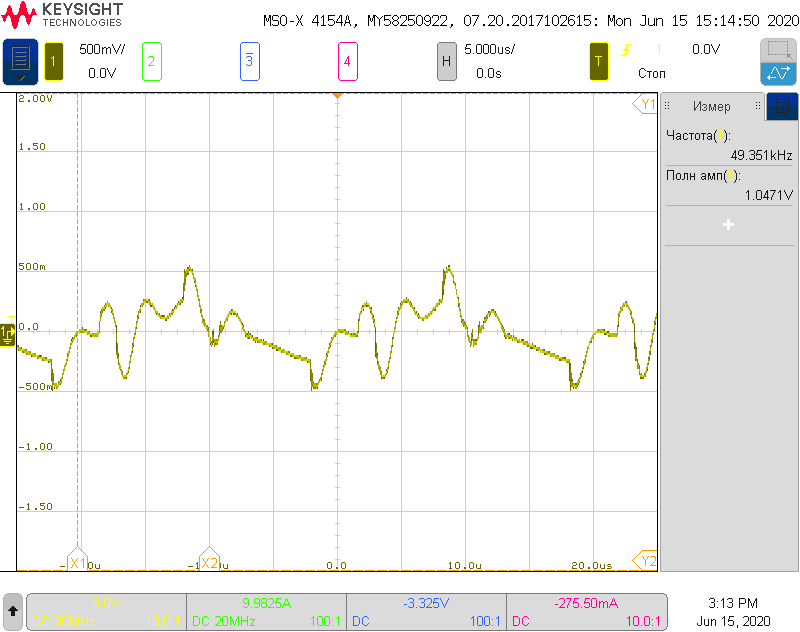

Hello! I an working now with PSFB using UC3875 and i know, it is quite old part but I have them in stock and I would like to use them, moreover, the question is more theoretical. I got question about MOSFET driving transformer configuration. I already have 4 transformers available and I want to control each transistor separately, as in the figure. But I ran into a problem when I connect only one channel (B), the current consumption increases significantly to about 180 mA (even if secondary of TB1 totally disconnected from QB1 R5 and R4 missing). When you connect all four channels instead, the PWM signal at the transformer outputs collapses. What could be the problem?
Transformer parameters are follow: core RM4, N87 material, ratio 1:1, Np=Ns=21 turn. Supply voltage 12VDC

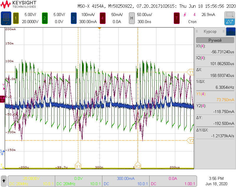

  • Hello Colin

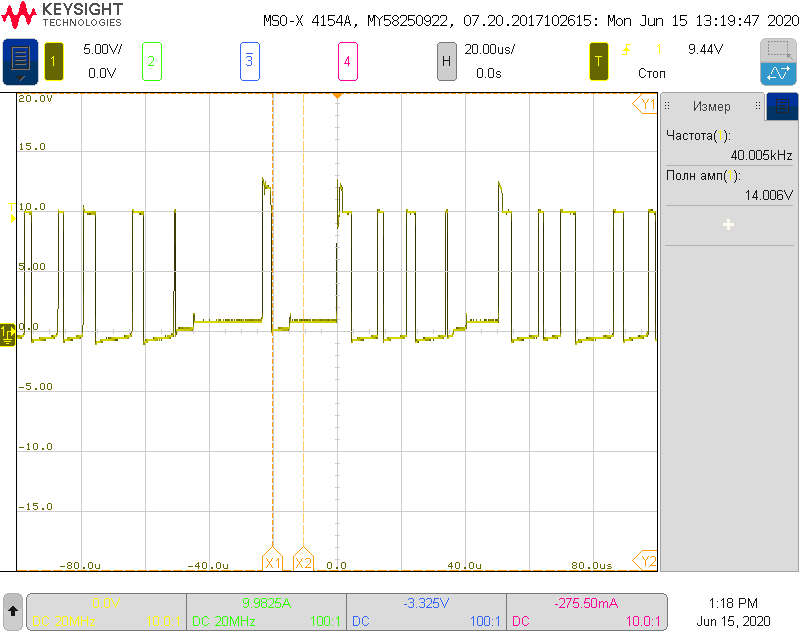

    Today i tried to connect two new transformers (i made two new, in order to make sure that there is no short circuit in old transformers) i connected them both to the OUT AB and CD but situation is not changed much. There is just no stable PWM at output (but current consumption around 150mA). The IC is obviously in some kind of protection. There is no stable voltage on soft start pin (just some noise), hence no voltage on EA out. As soon as i disconnect load from IC outputs it seems to work fine (soft start voltage also rises to 5V without any problem at no load) - see waveform on OUT B with no load:

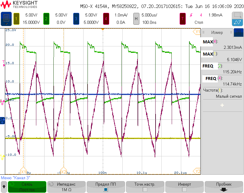

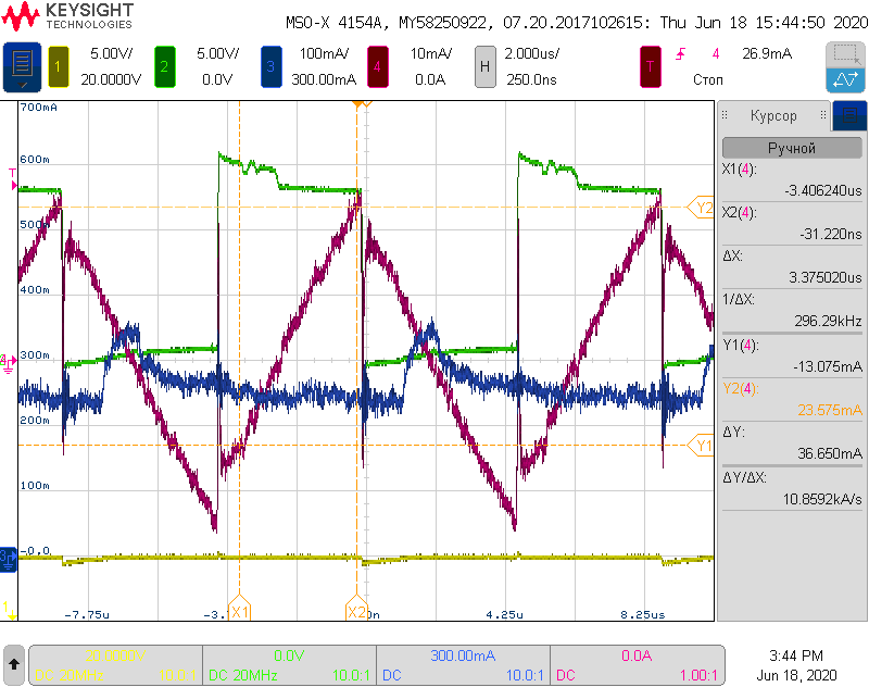

    I also connected 10R resistors in series with transformers to get a current waveform, but it changing time-to time. Here is two waveforms on 10R series resistors when only one of the outputs: OUTB or OUTD connected to the transformer at the same time:
    OUTB only
    OUT D only
    Here i connected all of the 4 outputs to the transformers, but i removed all components on transformer secondary (no any load on secodary) and total current consumptent droped to around 80 mA but there is still no any PWM at output (only some hearable noise from transformers). Here waveforme before c16
    Tomorrow I will try to load the chip with a purely resistive load - a potentiometer and see when the problems begin. I also have such a chip in the DIP case, I will try to assemble it on a breadbord and load it too, for comparison. By the way, 1 uF sireal cap is a good value, there is should not be any problem with this?

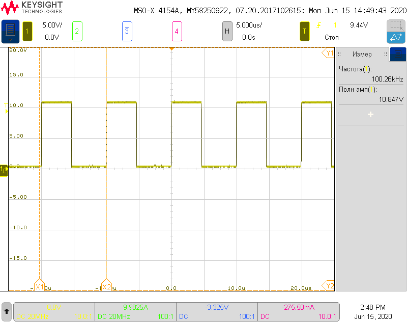

  • Hi Vasily
    The first waveform showing the current in the 10R resistor looks reasonable, 4V in 10R = 400mA.
    I wonder if the controller is hitting it's UVLO point - the OUTB waveform is about 11V which is not much greater than the UVLO point at 10.75V (11.75V max)

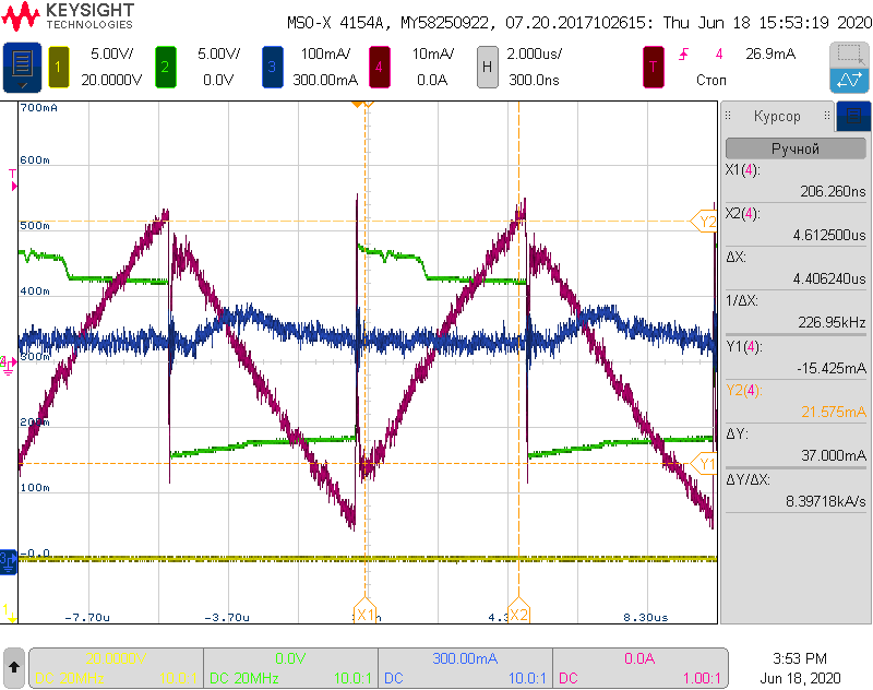

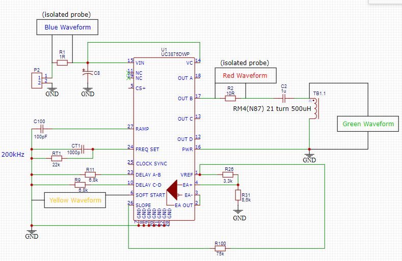

  • Hi Colin!
    Today i made UC3875 on a breadboard and it seems to work well at no load condition. Frequency set also 200 kHz and on OUTx i see 100 kHz PWM. I checked OUTB with pure resistive load, and it's doing good up to 1 Amp (not checked any further). Next thing i made a transformer with only one winding (primary), RM4 core N87 material, 21 turn, 500 uH measured induction and connected all it in such manner:
    Results:
    Current consumption starts from 300 mA (limit) and then slowly drops to around 160 mA@15VDC in roughly one minute. PWM controller gets pretty hotty! 60-70 ~deg.C

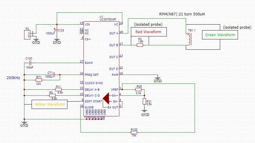

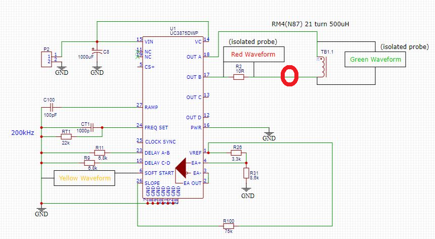

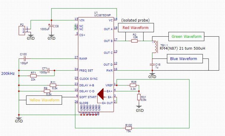

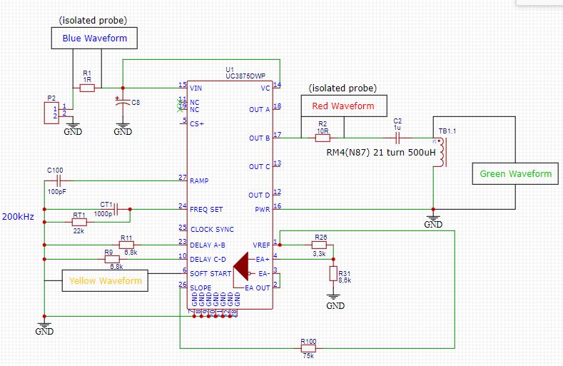

    Next configuration i made is to connect my "transformer" to out A and B, please see picture below:
    Result:
    As SS voltage LOW, IC didn't started-up.

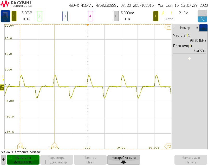

    In the third experiment, I replaced RM4 N87 500uH (21 turns) with RM8 N87 5 mH (40 turns) and connected everything in the same way as the first circuit. Everything seems to work fine. Please see some waveforms:
    I can not understand why with RM4 it does not work properly. Isn't an inductance of 500 μH enough? The current does not even come close to a large value.
    Vasily

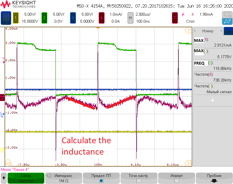

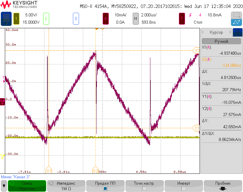

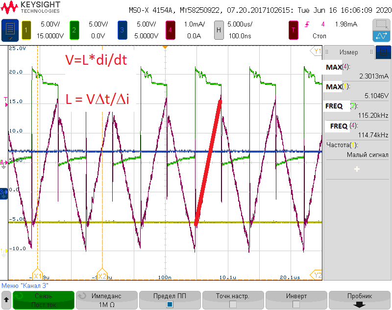

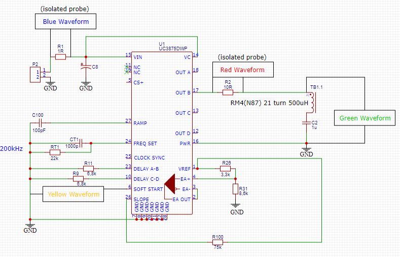

  • Hello, Colin!

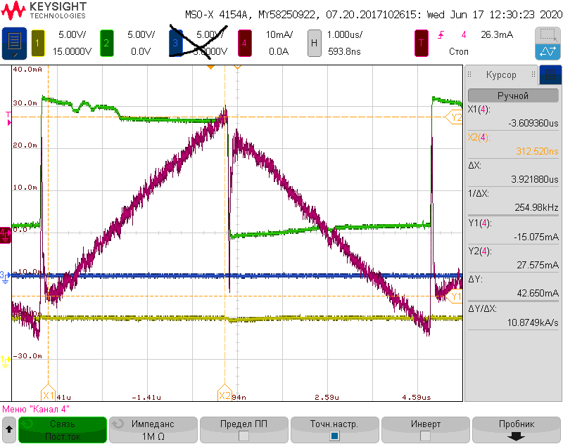

    I double checked my connections and, D'oh, I forgot that my diff probe (waveform on 10R) has 10: 1 ratio! I'm sorry to confuse you, it should be 10 mA / div instead 1 mA / div in all previous waveforms. It's actually ~ 280 mV peak at 10R resistor which is 28 mA peak. I reconfigured my settings and now it should be the right ratio. In all new waveforms it's the correct settings for current.
    Today I repeated my first configuration with a transformer from OUTx to GND on a breadboard and on my PCB and the results are pretty close.
    Setup:
    Results:
    On breadboard (with my new hand made RM4) please ignore CH3,i forgot to turn it off:
    On PCB (with original RM4) markers are little bit displaced, sorry:
    I calculated inductance as you advised and got following results: first case (breadboard) dI=42,7*10^-3A; dt=3,92 * 10^-6 s, L=U*dt/di=7,5*3.92*10^-6/42.7*10^-3= 689 uH vs (500 uH measured) If we take into account the voltage drop across the 10R resistor and in the IC, the result will be closer to the truth.
    Second case (PCB)
     dI=40,7*10^-3A; dt=4,4 * 10^-6 s, L=U*dt/di=7,5*4,4*10^-6/40,7*10^-3= 811 uH  vs (600 uH measured)
    Problem: SS voltage is 5V and it's somehow works. PWM controllers current consumption is near 200 mA in both cases and it is hot! Definitely something wrong with this!

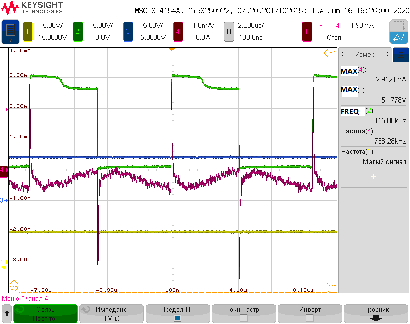

  • Hello Colin!
    I understand that 5 volts is the normal level at the SS pin. The reason why I show this level in my oscillograms and refer to it is that if it is LOW, I conclude that the IC has gone into protection mode and you should not expect a stable PWM signal at the outputs. (Note this at last waveform)
    Without transformers, the chip consumes only 43 mA @15 VDC.When a transformer is connected, for some reason I do not understand now, the consumption increases significantly to 200-300 mA while the current through the transformer corresponds to the calculated value of ~ 20-30 mA. For clarity, I attach measurements of this input current. Please note that it is more or less constant.
    Setup on breadboard:
    Measurements:
    Then I repeated everything on the PCB, setup (Please pay attention to a different location of C2 (I can not measure here differently))
    Measurements:
    If I connect 2 transformers in this way (output B and D), then the IC stops working. Pay attention to the level of the SS (yellow) signal. Here are the waveforms of this process.
