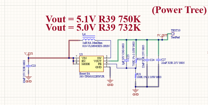

Hi, i have a problem with the noise produced by the Inductor of the boost. Its audible and affect on the Audio output of the circuit.
Note: the 1pf capacitor on the feedback resistors its not soldered, C25 on the schematic.
This its my circuit at this moment, as you see i force the mode to PWM to solve about 60% of the problem, but when the input reaches low voltages near to 3V (its a Lipo 1 CELL the battery input of the circuit) it starts to emite audible Noise.
The charge of the circuit its a computer module 3 from raspberry pi, so we will have a minimum load of 0,5A on the 5V lane, and a maximum of 3A. In theory the datasheet sais thad from a LiPo battery this integrated can offer 0 to 3A without any problem, and it works really good, but the problem for me its the inductor.
It's my inductor a bad choise maybe?, its a VLS6045EX-1R0N, and following the specification of the datasheet it should be valid for the design.... or i am wrogn?

  • Hi Carlosp,
    please try to increase output capacitor. It could be caused by the stability. also measure the VIN and VOUT waveform.
  • Hi Jasper, i will test today with a higher Ceramic capacitor out, at this moment it have 2x 22Uf and one 22Uf extra capacitor.
    One question, should we solder a Feedback capacitor?, at this moment its unfited.... but the datasheet and the Excel recomend to introduce one. In our practices this capacitor create some noise and unstability, but could be a problem from our side.
    Regards, Carlos..
  • Hi Carlos,
    1. The selected inductor VLS6045EX-1R0N saturation current 12A is high enough but the Itemp spec 6A is quite marginal. When output power is 5V*3A=15W, assume the efficiency is 92%, the average input current is 15W/0.92/3.0V=5.43A. The inductor temperature rise is around 30-40 degree but it's ok as it only works at 3.0V Vin for very short time. And it should be not to root cause of audible noise.
    2. The feedback capacitor is not necessary. It is only needed when you want to optimize the loop response speed.
    3. Can you share the layout and probe the SW pin waveform. The device is working at FPWM as you connect MODE pin to Vin so I'm quite curious why you can still hear audible noise.

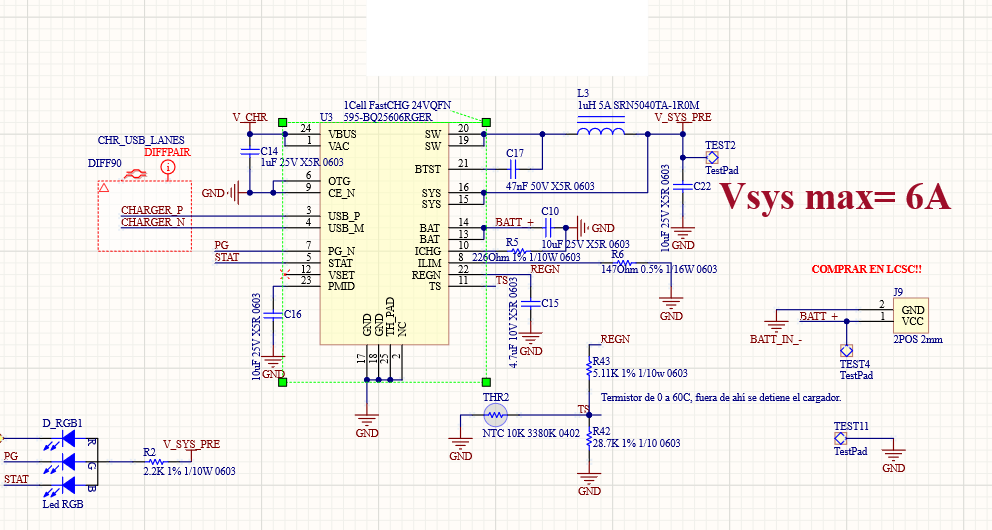

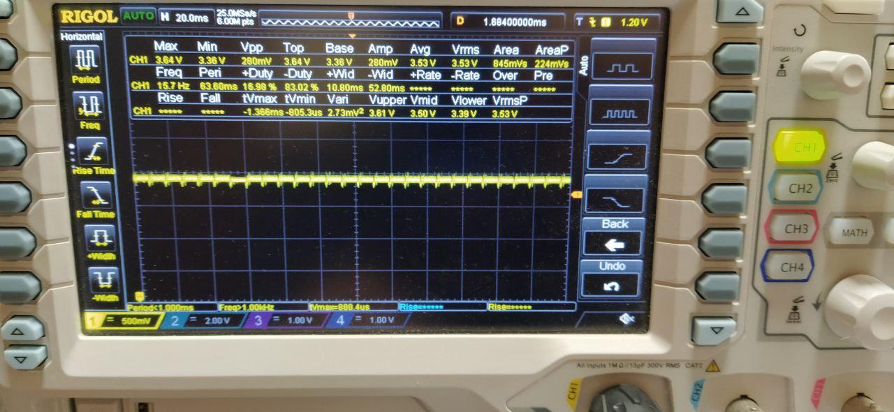

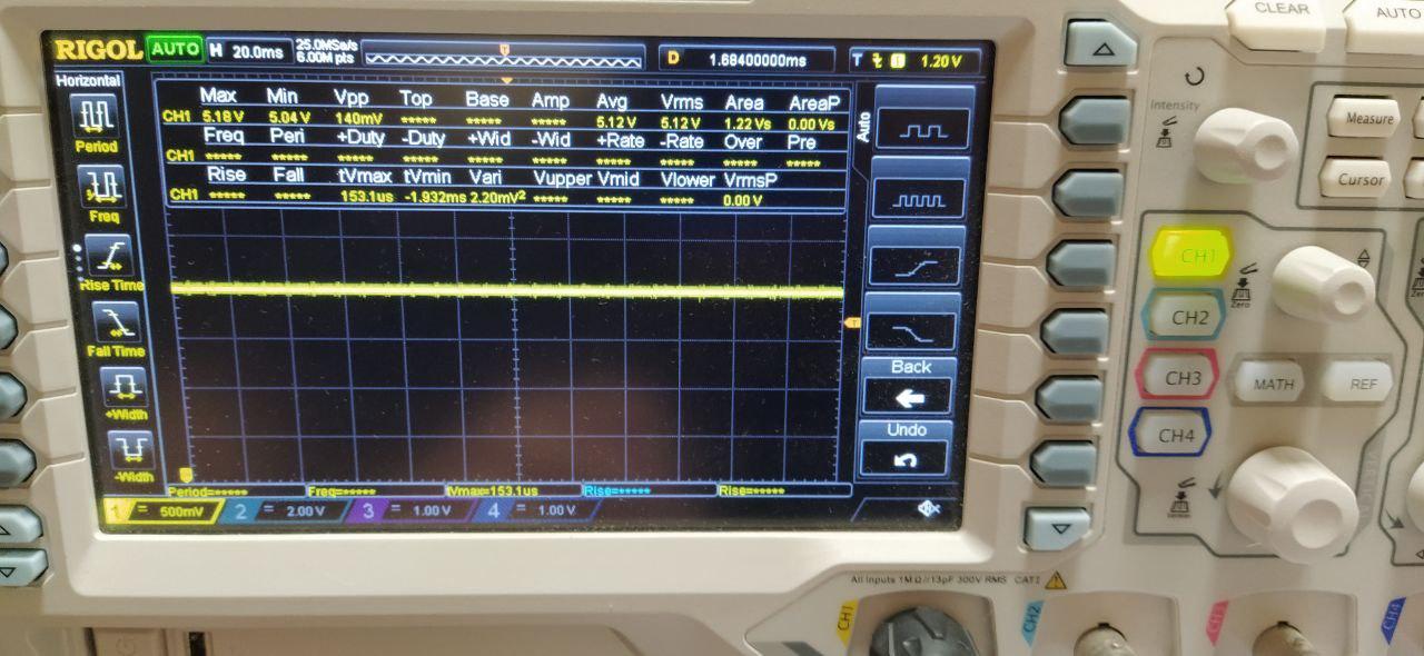

  • Attached the images of the otputs. It seems to be OK and without any problem. The noise get sync with the Processor Noise of the computer module3 from raspberry, and now its really really low, you need to put the ear over the inductor to hear that.
    Kinda strange, its the first time something like that happend to one of my desings. The charger its from TI too, its a BQ25606RGER.
    Then the L2 its a GND plain.
    As the product will be closed, on this relase we will accept that noise as normal, but in the next review we should correct it, maybe selecting another Boost from texas instrument with a higher frecuency.

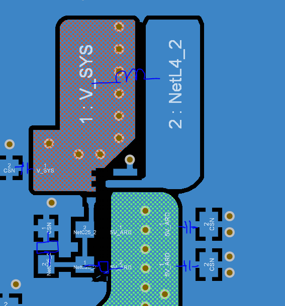

    Besides Brigittes's suggestions, you can also probe the SW pin waveform. We cannot tell if the loop is stable or not by only watching at VOUT pin waveform because it only shows up the DC level. If you see the SW pulse width unfixed, it proves the noise comes from inductor. If the pules width and duty cycle are quite fixed, the noise may come from other part on the board.
    I see the layout of your board is not good. The output capacitors are not placed close to IC VOUT and GND pins on top layer. We used to see the device failure cases with similar layout on E2E. Please update the layout per AN: SLVAES4
  • Thanks Brigittes/Zack. Well noted about the layout design, so i was doing it wrong in a lot of buck/boost designs, i will change my designs in order to fit those APP guidelines.
    First capacitors, then i can routed the Feedback lane.
    I will try to look for some inductor that can fit on the footprint on the board, any sugestion?, and test to solder it throuhg wires. Maybe the noise comes from the broadcom CPU of the raspberry itselfs.... when i run the stress tests i could appreciate how the noise gets sync with the CPU load, but if i use a lab power supply instead of the Boost i cant hear any noise.
