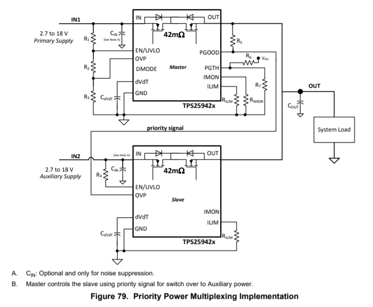

I want to make Design  with USB & Battery (4XAA alkaline) Operated.
Design will work on USB when Battery available.
Design will work with battery only when USB supply is absent.
supply need to be switched automatically  so design will get continuous power.
can you suggest any device or any solution for this.
