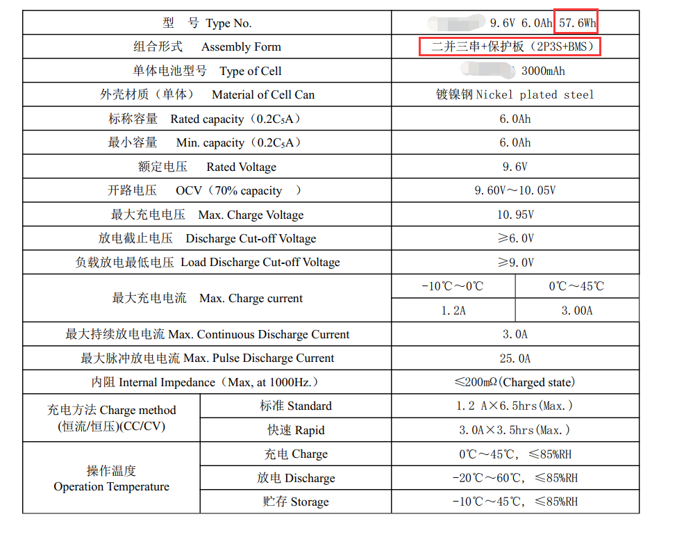

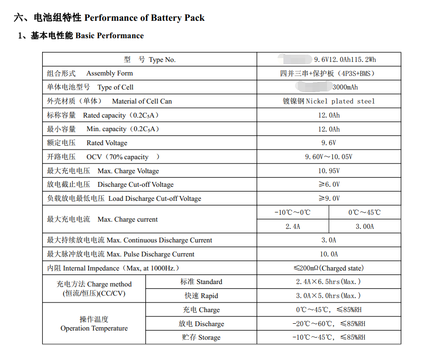

Our customer have below 2 types of battery pack, do we have more suitable devices? Only pack+ and pack - is open.
Battery material is LiFeO4。

Hi Rushi,
I promoted BQ40Z50-R2 before, but the customer said only pack+ and pack- are open, they can't connect every cell + and -.
They just need the gauge function.
So I promote BQ34Z100-G1 to this customer. I want to confirm it with you.
Rock Su
Hi Rock,
If customer can't connect every cell then BQ34z100-G1 is the proper device.
