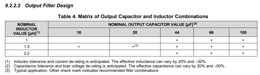

My customer would like to check if it is fine with 2.2uH and 22uF. Vin is 3.3V and output is 3.85V/24mA. The 22uF is a 6.3V ceramic.

we didn't verified this combination. as the output current is small in this application, it may be OK, but customer need to verified the stability and ripple in their system.
besides this 22uF , is there any capacitor in parallel but closed to the loading?
