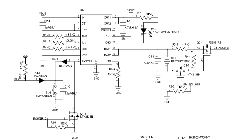

Hi Sir,
We encountered a problem when using BQ24075.  We found that when our product is powered off and charged, it cannot be charged normally. We can only charge the battery when it is powered on. The schematic diwe used is as follows:
Pls give some recommendations on this case.
