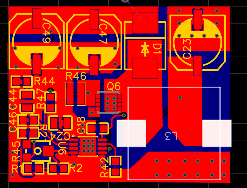

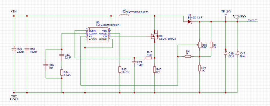

I have made a step motor driver board with LM3478 to supply 24v from 12v input.
LM3478
The problem is that a user can power the board without the stepper connected board which drive the board to no-load status on LM3478. Just 2 stepper motor drivers(drv8825) are connected to 24V.
LM3481
After LM3478 circuit is broken and burnt, I googled the problem and found LM3478 is not a proper choice for this situation.

  • Hi Garrett,
    Thanks for the comments.
    So, you mean the no-load condition should not be the reason for LM3478 self-destruction? The ripple is fine.
    I am attaching the schematic and layout for your reference.
    R1, R2 is not used
  • Chanoh,
    The ripple on the output voltage should not damage the LM3478.
    Is R1 in your schematic really 1kOhm? This seems too small for the top feedback resistor. Please follow the datasheet on how to select the correct feedback resistor values.
    Garrett
  • Hi Garrett,
    Thanks for checking. R1 and R2 are not mounted. They are for test purpose only without R45. From the schematic and layout, do you see any other reason that my board should fail?
  • Chanoh,
    What is the operating condition when the LM3478 is being damaged? Is it damaged on the initial start-up? Or only during a certain operating condition?
    If the device switching please capture the switch node voltage, the VIN pin voltage and the FB pin voltage.
    Garrett
