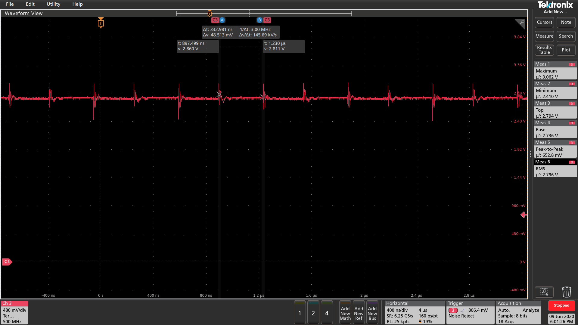

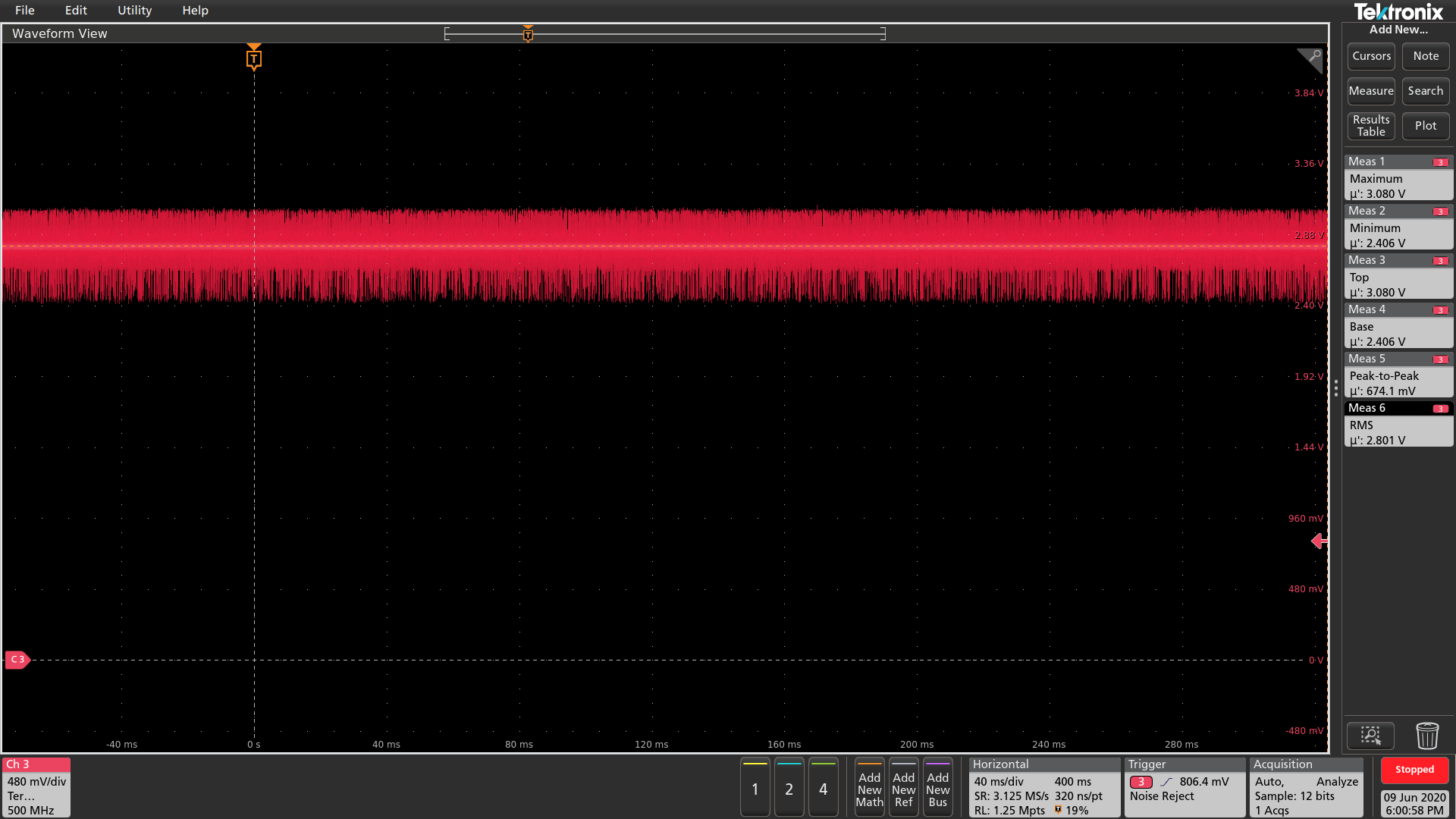

    1. Can you please provide a waveform of the coupling to the switch node?

  • Hi Mike,
    1. Waveform as below. Double the switching frequency of boost inside the BQ25883 (switch on and switch off in each cycle, so twice)
    So what's the sample way? Single Sample or Multi Sample for a single temperature value out?
    I advice to add a capacitor to ground on TS pin, I think can make great improvement, but still want to know the sample and temperature calculate method.
