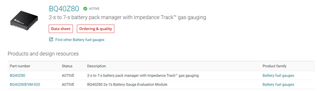

Explain the following figure, read all the materials of link 1 and link 2, and design the project according to the hardware connection of these documents, but there are still problems.
See file for picture: figure of link 1 and link 2

    In order to connect the BQ40Z80EVM-20 board, you can use the on-board EV2400 by connecting it to a computer using a micro-USB cable. In this configuration the jumper settings for J18 should connect pins 1 and 2, and the jumper setting for J22 should connect pins 2 and 3. From here you can program the EVM using bqStudio.
    Alternatively you can use an external EV2400, you can refer to the BQ40Z80EVM User Guide(Section 2.3) to check how to enable the external EV2400. You can also see how to configure the bq40z80 in this user guide(Section 3).
    Looking at your word document, to configure/program your circuit board(BP), you need to connect it to an external EV2400 by connecting P4-2(SMBC) and P4-3(SMBD) into the appropriate pin locations of the external EV2400, for more information you can refer to the EV2400 User Guide(Section 2.6). From here you can program the bq40z80 using bqStudio.
