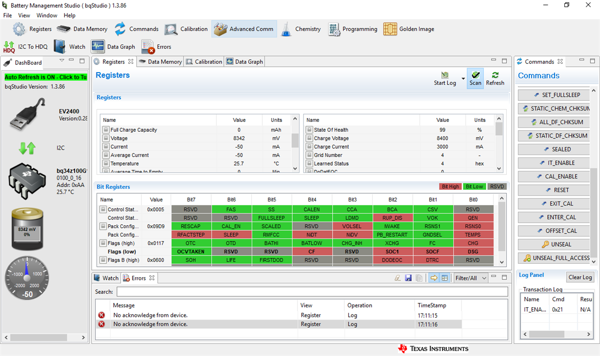

1) I am trying to get a fuel gauge ready for a 2s Li-Ion 6000mAH 4.2V max. The battery which I am using is from a local vendor which does not have any Datasheet, and also If i have to program a CHEM ID for the specifications mentioned above, without having to check Gauging Parameter Calculator: Match chemistry for Impedance Track gauges, as I have very less time to Complete the project, Can you please help me which CHEM_ID can I use it. I am unable to perform a successful Learning cycle as the BITS that determine the charge and discharge cycle are not acting as mentioned in the Technical Reference, even after passing the IT_ENABLE.
2) And since the Default settings are fro Li-ion, Is it Okay to just set the data flash without performing Learning cycle?; will the gauge LED's Work this way?
