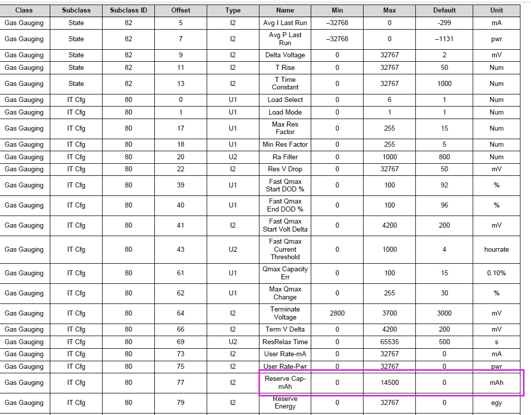

My customer is using BQ27524-G1 in cell phone. After the phone's battery is 0%, it still needs to be placed for one month. So the customer wants to reserve 125mAh in the reserve capacity register. But when the SOC is 0%, test the remaining capacity is only 100mAh, less than 125mAh. The terminate voltage is 3150mV, load is 180uA.

  • Hello Minqi,
    The reserve capacity setting will show 0% Remaining Capacity at the point the battery has the amount of reserve capacity specified.
    Has a complete learning cycle been done and configured on the gauge? Without a successful learning cycle it could cause the gauge to miss the 125mAh programmed reserve capacity.
    Could you send a log file of the discharge and the .GG file of the configuration?

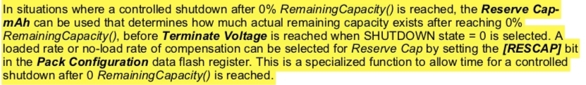

  • Hi Keller,
    Thanks for your reply. I'm getting customer to send the log and gg file.
    But I still have one question to explain to customer. I'm confused about the yellow part word, could you help to explain " A loaded rate or no-load rate of compensation can be selected for Resreve Cap by setting the [RESCAP] bit in the Pack Configuration data flash register. This is a specialized function to allow time for a controlled shutdown after 0 RemainingCapacity() is reached"? Thanks for your support.
  • The loaded rate is a simulated reserve capacity similar to the gauge if it is running with a load current.
    the no load rate is using just a standard subtraction from the computed remcap.
