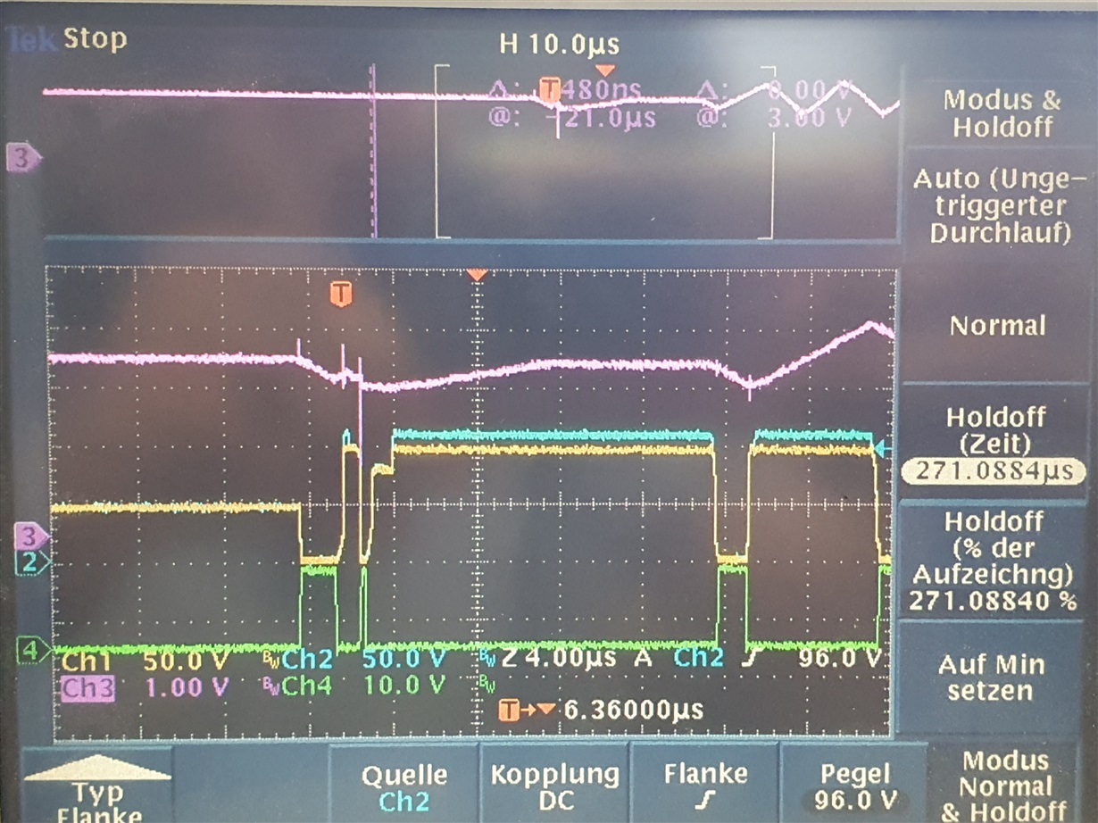

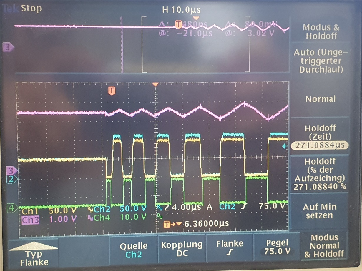

I have been working on a 2kW battery charger project. I use UCC256403 as the main Power Supply Controller. I am currently testing at lower input voltage to ensure functionality in every mode before using the high voltage input. I observed some unexpected switching pattern in some Burst mode cycles. Below are the images of the various waveform at different pins.
Ch1: HS pin                        Ch2: HO pin
Ch3: VCR pin                     Ch4: LO pin
Erroneous Operation:
Expected/Normal operation:
Under Erroneous operation, Controller seems to turn of the upper MOSFET after approximately 250ns. I cannot seem to justify this behavior. It would be really helpful if I could get some support regarding this.

    Under what condition can the Controller turn off Upper MOSFET prematurely? How can the ON time suddenly jump from approximately 2us to 250ns? It would be really helpful to get this information because even with soft burst ON as per my design, the max. frequency must be well below 500kHz.
    250ns corresponds to 2Mhz.
  • Not sure if you see this from one of our experts.
    It looks like noise on VCR made the VCR waveform cross the VTH turn threshold early and this is causing the controller to turn off HO after only 250ns. The good waveform shows no spike/switching noise in the VCR waveform. Would also be interesting to compare the FB pin voltage between the good and bad burst patterns. I am wondering if the opto-coupler saturated and is causing the FBreplica to behave differently between the good/bad burst packets.

  • Layout is as optimised as it can be. Moreover this project is near end development stage. Any changes to the layout now is not practical. This layout worked fine till the last revision. Then we made some changes due to EMC issues. It initially used UCC265303. I switched to UCC256403 because the former would latch and stop switching when this case occurred. A layout change at this point is not feasible. Since the problem occurs only at considerably high frequencies, we will probably continue with the measures to avoid it.
    Moreover I am not 100% sure whether the Controller turns OFF the upper MOSFET due to the noise or the noise occurs due to the premature turn OFF. It would have been beneficial if the controller had some blanking time to ignore these high transient noises.
