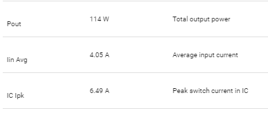

Hello, I am trying to use LM61460 in my system.

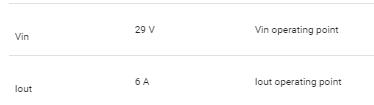

My system will use 19V, and  maximum current  6A.
I tried webench Power designer using LM61460, and I have some questions about the results.
(I set Vin 21V - 29V, Vout = 19V, Current 6A)
Below is the result.
I out is 6A, but Ipeak is 6.49A. Is this Okay?
In the datasheet max current is 6A, so if Ipeak is 6.49A then it will go over the spec.
Can LM61460 handle 6.49A I peak current? If it can, then what is the real(?) max current that LM61460 can handle?
  • Hi
    it can handle the 6.49A , the peak current means the 6A-dc+0.5A-ac(0.5X inductor ripple), the peak current limit min value is 8.9A, so if you peak current not over 8.9A, the converter will not limit the output, but you may need care about the thermal with high current output
    thanks
