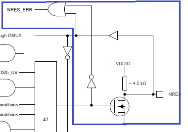

I'm not sure why a state transition ACTIVE -> SAFE instead of a transition ACTIVE -> RESET should occur, if (WD_FAIL_CNT=7+1 & WD_RST_EN=1) and (NRES_ERR=1).
Assuming the PMIC is in state ACTIVE and the watchdog tries to set NRES = 1 but NRES keeps 0 instead due to any random fault.
According to figure 6 in the TPS65381's datasheet from my point of view in this case there are two possible state transitions:
(T1) ACTIVE -> SAFE as NRES_ERR=1, provided DIS_NRES_MON=0 // Priority III
(T2) ACTIVE -> RESET as (WD_FAIL_CNT=7+1 & WD_RST_EN=1) // Global Reset Condition , Priority II.
But as T2 is of higher priority than T1 in this case T1 would not happen.
So my question is, in which cases transition T1 is taken?
Maybe the answer is already given by figure 5-14 in which NRES_ERR is driven in two cases covered by the XOR gate and not just the case called in section 5.5.4.5.
Thank you in advance for your support
Stephan

  • Good morning, Ivan,
    Sorry for my mistake, the correct reference is figure 5-16, not figure 6.
    I understand the higher priority of the global reset condition compared to a priority II transition.
    But how about the deviation between figure 5-14 and section 5.5.4.5?
    As i understand figure 5-14, the case (pin=high, control=low) called in section 5.5.4.5 is only one of two cases covered by the xor gate in figure 5-14.
    The other would (pin=low, control=high). In this case the priority II transition to SAFE state would be taken but the transition to RESET state due to the global reset condition would not, right?

  • Hi Stephan,
    Although in theory NRES_ERR could be set to 1 due to two scenarios you have already identified:
    • Scenario 1: (NRES pin output HIGH and NRES pin input readback LOW) and
    • Scenario 2: (NRES pin output LOW  and NRES pin input readback HIGH)
    Only under "Scenario 1" the application could be able to read NRES_ERR status and the device's state machine would only be able to react to this fault if the device is in ACTIVE state and DIS_RES_MON = 0.
    In order for "Scenario 2" to occur, NRES pin need to be LOW. Which means that either the device is either on STANDBY or RESET state. As shown in Figure 5-16 of the datasheet, the device could be on STANDBY or RESET state due normal state transitions or due to a PRIORITY I or II. Therefore, a transition to SAFE should not occur under Scenario 2 (Please note that all transitions to SAFE state are PRIORITY III).
