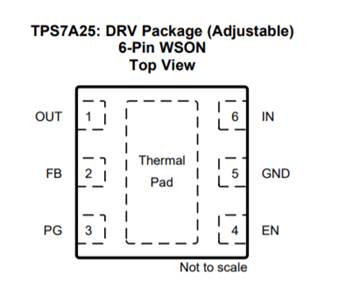

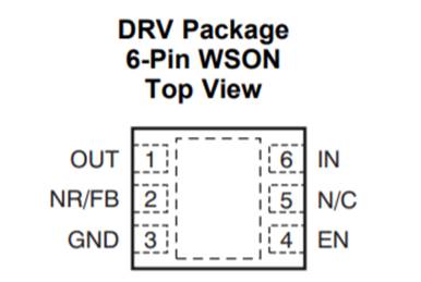

We have an urgent support need below. Previous my customer is using the TPS7A37 to achieve the 3v to 1.5v (1mA) requirement. For the device's iQ is too large, they need to find P2P device with the TPS7A37 and with <10uA IQ current(adjustable version). So i have found the TPS7A2501 (the same package) for them. But also want to double check with you about the items below.
1. whether the package is the same?
TPS7A37 |
2. Whether we can connect the PG to GND?
3. if we want to get the voltage 1.5v. Could you please help check the feedback resistor and cap?(Cin=10uF, Co=10uF, R1=129kohm, R2=1Mhm,Cff=22nF)
