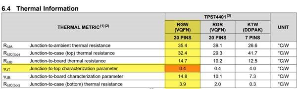

I was wondering if you could help us out, or point us in the right direction in regards to Junction Temp. Estimation for the TPS74401RGW.

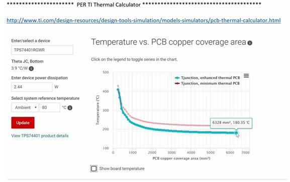

We originally measured the case of the device to be ~ 93*C and ~2.53W  (3.3v to 1v @ 1.1A).
Using the original “Theta Jc” metric;  We get a Junction Temp. of approx. 172*C
The TI online calculator seems to agree. (Reports a Junction Temp of ~ 180*C
Therfore, by using the “Theta Jc” ϴ metric, we will need to use the DDPAK part moving forward, as this smaller package is causing the Junction temperature to exceed the recommended operating condition temp of 150*C  (172*C vs 150*C (~22*C Exceedance))
Then, ”Psi ψ” is brought to our attention.
According to this, an estimation of Tj (Junction Temp.) can be made using the following:
The ψ JT  is….. 0.4
http://www.ti.com/lit/ds/symlink/tps74401.pdf?ts=1590772500775
Therefore, our updated Junction Temperature using ψ JT  is:  ~94*C

  • Hi Michael,
    Using PsiJT is correct. ThetaJC is one of the many thermal resistance paths from the die to the ambient
    The most common error with measuring TJC is using the wrong thermocouple. The JEDEC standard recommends a 36-gauge wire. If it is a T-Type thermocouple then a 40-gauge wire is recommended.
    I hope this helps to answer your question.
