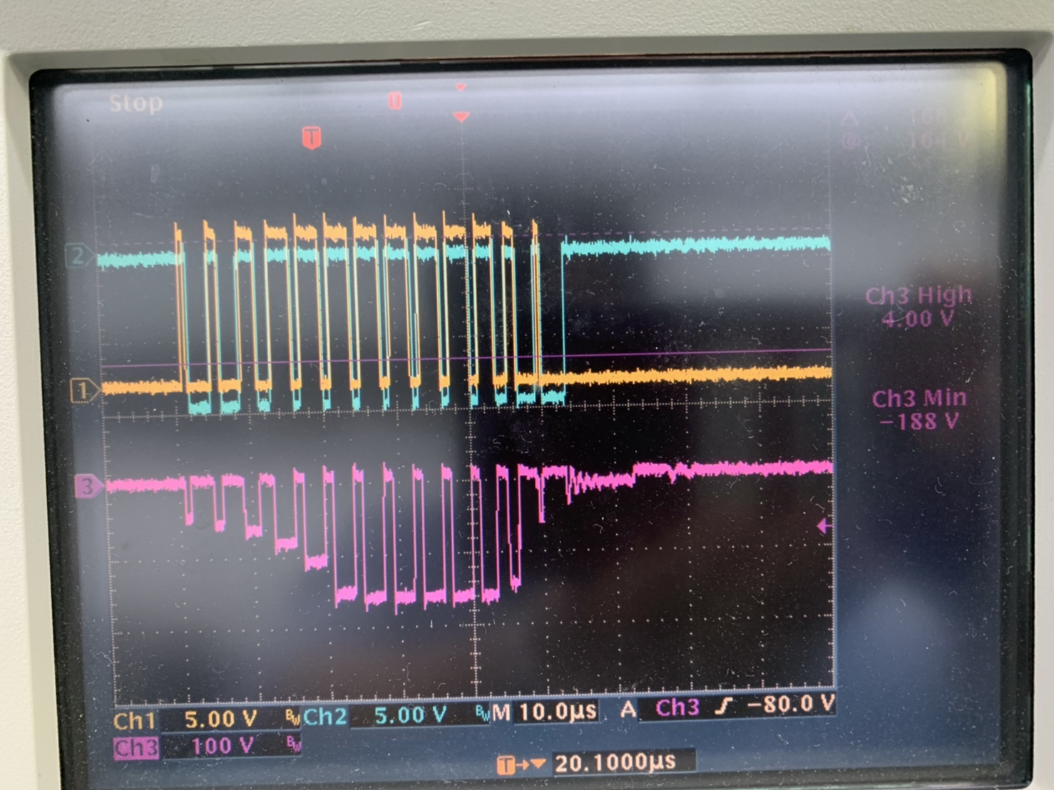

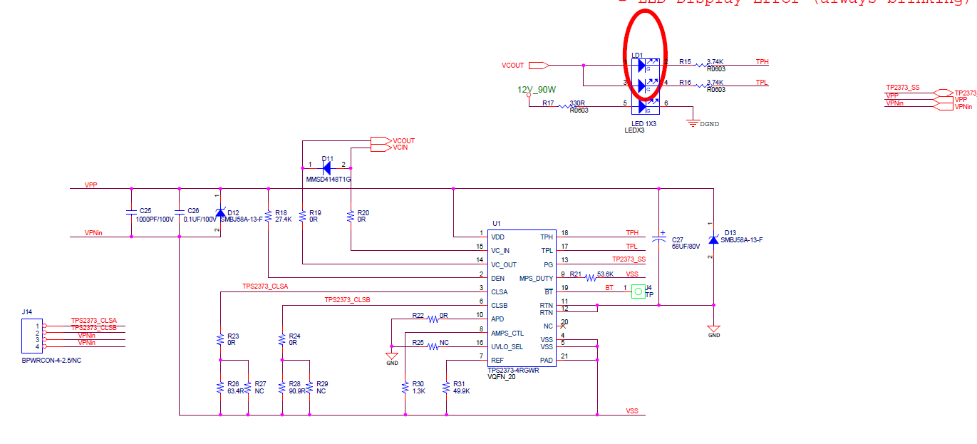

I design a TPS2373+UCC2897A as the following schematic, which is a 90W with 12V output and 7.5A  but now has something wrong in UCC2897A, it's can't boot.

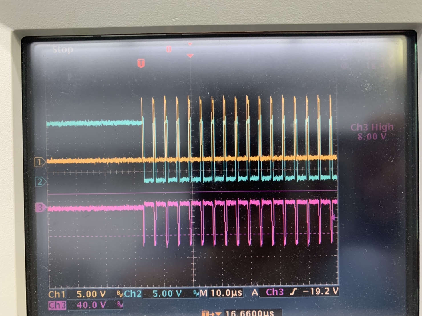

The following is the experiment I have done.
1. T1 11.5uH(Np:Nbias:Ns=1:0.666:0.5) , L3 33uH.
2. Disable U1 TPS2373, R17, T1, L2.
3. Change SR MOSFET to schottky diode and disable peripheral components ( D16, D17, D18, D19, Q5, Q6, Q7, Q10, R32, R33, C32, C40)
4. Gives 48V at C30
5. Give 12V at C52
After the above experiment, the output is 3~5V, but I designed it to be 12V. Where did I neglect or where should I start debugging? thanks.
