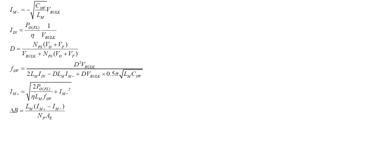

IIn the datasheet, the frequency formula is as below( page 40 in datasheet).I am not sure the frequency formula. I know the period includes the conduct time and the resonant time.
But my answer is different with yours. Would you please simplify provide the deduced process?

    The switching frequency equation (fSW) on page 40 is derived from some simplification of the ideal Transition-mode waveform timing plus modifications for the extra negative current portion and resonant ringing portion. The switching period tSW is the inverse of the fSW, and tSW is the sum of the on-time, the demagnetization time, the negative current time, and the resonant time.  The various parameters are arranged such that it is not necessary to know Ipk for any of the conditions.  Unfortunately, I cannot simplify it further for you.

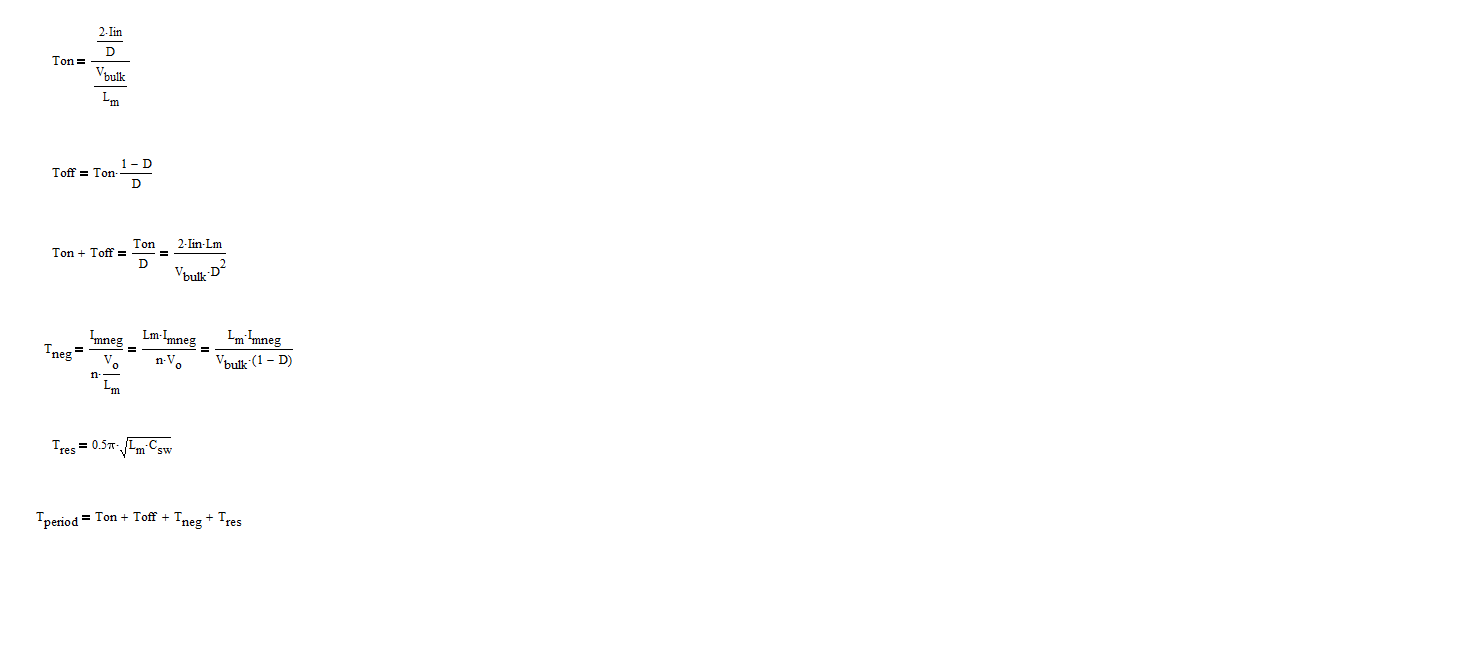

    But for frequency I still wonder the formula. I know that the frequency is the reverse of the period and also the period include the on/off time and resonant time.
    But for the detail separate time I didn't know the concrete formula. I also list the deduced process of mine, which is much different with yours. Would you please take a look at the calculation and correct them?

    I believe that there is one error in the Tneg equation where you equate nVo with Vbulk(1-D).  I believe that this is not true.
    I do concur that Ton, Toff, Ton + Toff, and Tres equations are correct.  I tried to work through this in detail and I think the system engineer made some simplifying assumptions to arrive at the fSW formula in the datasheet.  I need to confer with the system engineer to understand and validate these this assumptions.  Please give me a day or two to pursue this and find out the full derivation.

    I agree that Tneg is wrong by my clerical error.

    I apologize for the long delay.  Here is the derivation provided to me:
    Mathcad - fsw expression for ACF.pdf
    Ulrich
