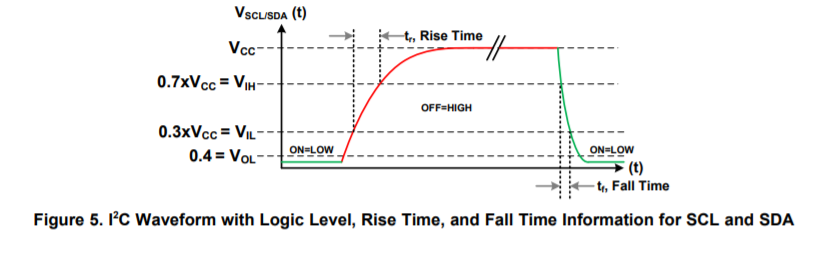

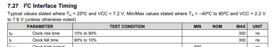

I would like to check the I2C clock rise/fall time spec. for bq28z610. I have two questions.
1. the max time (300ns) for clock rise/fall time is for fast-mode (400 Khz). Am I correct?
2. What is the test condition for clock rise/fall time in the datasheet? 3.3V? 5V? In bq30z554 R1 datasheet, it specify the test condition "Rise time tR = VILMAX – 0.15) to (VIHMIN + 0.15) , Fall time tF = 0.9 VDD to (VILMAX – 0.15)" for SMBus. Is the test condition the same for bq28z610? Thanks.
