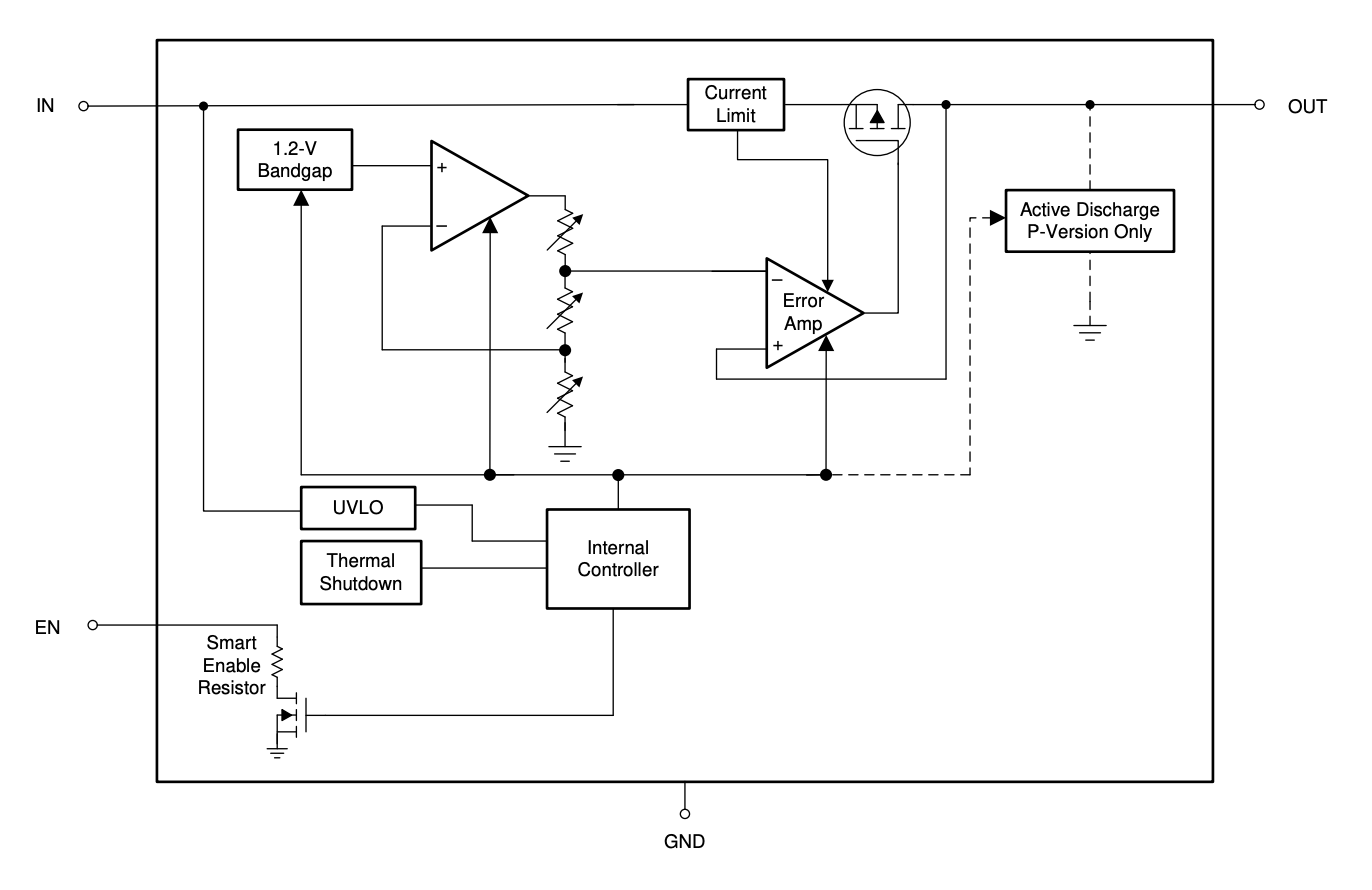

My Customer sue our part is TLV70033 , and they require that they wander to know the internal resistor value of output feedback in compactor.
Because these information I also not to see on the datasheet .
Could you please to provide to us and let me explain for them ?
Eddie

    The customer use two set device to supply their DSP DVCC and AVCC pin , and when the DSP into the low power mode will turn down the AVCC pin supply power , so the one of LDO are going to standby mode. at his time they find the LDO standby current are higher to the 80uA.
    They are curious our internal resistor value , because this will impact their power consumption  ability.
    So please provide this data for him , they will evaluate still use this device to design or not ?

  • Hi Eddie,
    The bottom feedback resistor is 1.14MOhms. so for 3.3V the total pulldown resistance is ~1.79Mohms.
    I hope this helps to explain the leakage.
