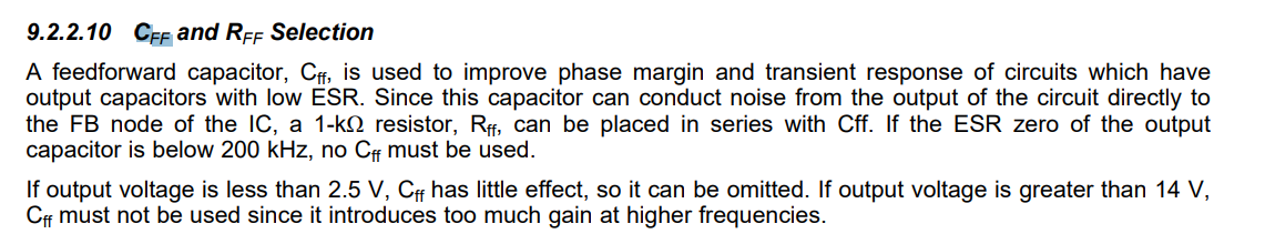

2. CFF is used for transient response.
But in the datasheet If output voltage is greater than 14V, Cff must not be used because this introduces too much gain at higher freq.
Refer to the datasheet, for me output voltage is 19V so I shouldn't use Cff.
What is the effect of too much gain at high freq? What will effect If I use 19V output with Cff cap?
