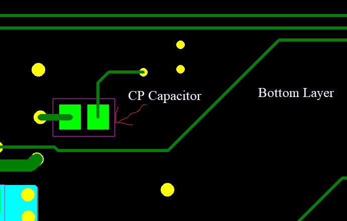

I am using the LM27762 power module for the generation of -5V supply from 5.5V input.
and I am using both the same module in a parallel connection to get more O/P current but I am not getting -5V O/P.
Initially, I am getting 0.4V of O/P when both the diode D6 and D7 are connected. But when I removed 1 diode both of them the voltage remain the same.
But whenever I removed both the diode D6 and D7 I am getting -2.35V  O/P of both the module separately.
Please review my design & Let me know where I am doing wrong.

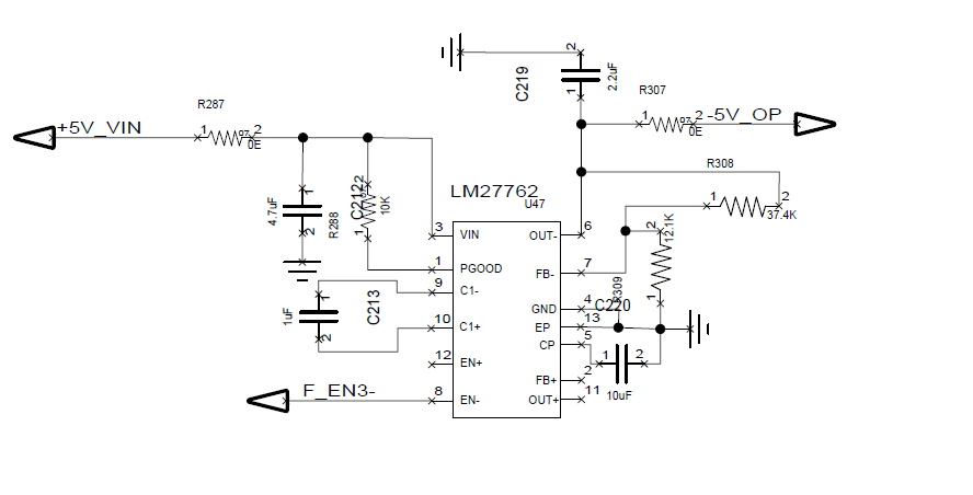

    Please review my other design and let me know.
    In this design R1 is 140KOhm and R2 is 51KOhm so as per the calculation I should get -4.56V and I m getting -4.55V.
    So I can't understand where I m wrong and where the issue in my circuit.

  • Hi Ashish,
    The new schematic you have sent doesn't have the diode at the output and also the resistors at the feedback divider do not have the values you mentioned in the previous message. R2 of 37.4 kOhms is not recommended as per the datasheet (the minimum recommended value of R2 is 50kOhms). Does your circuit still contains the diode at the output?
    Please send the most recent schematic and if you can also the most recent layout.

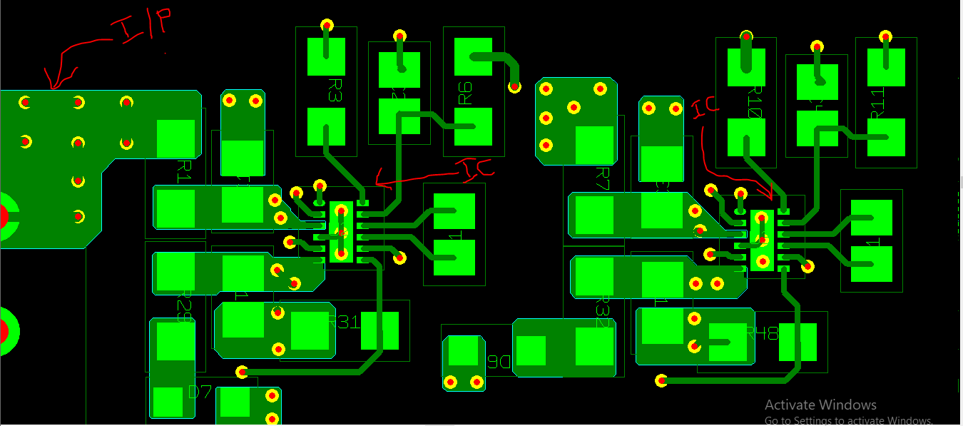

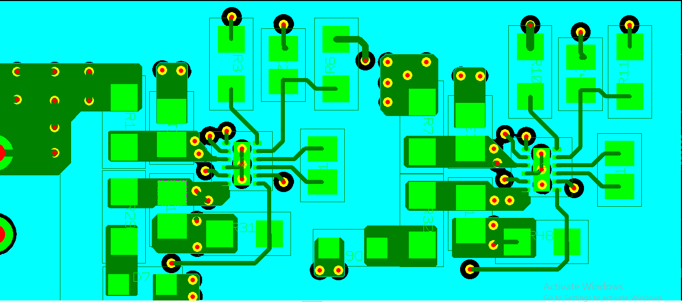

    Please review my layout.
  • Hi Davor,
    yes, I am using low ESR ceramic capacitors around 15 to 20 mOhms.
    The load of my application is around 300mA.

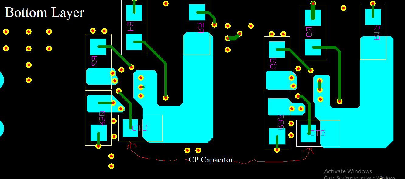

  • Hi Ashish,
    I have looked at the PCB layout and I have several suggestions to make:
    1. Ccpout should be placed on the top layer (same layer as the LM27762) and as close as possible to the VOUT and GND pins. The returns for both CIN and CCPOUT must come together at one point, as close as possible to the GND pin.
    2. Wider and shorter traces should be used for the flying capacitor C1 (it should be placed closer to the IC)
    3.R3 and R4 should be as close as possible to the FB pin and for best performance R4 should connect back to the GND connection at the thermal pad of the device.
    4. Avoid using too many vias since they add to the parasitic inductance
    These suggestions are also listed in the datasheet for the LM27762 on page 17 and 18. Also you could have a look at the layout of the LM27762 EVM shown on page 10 of the EVM user guide.

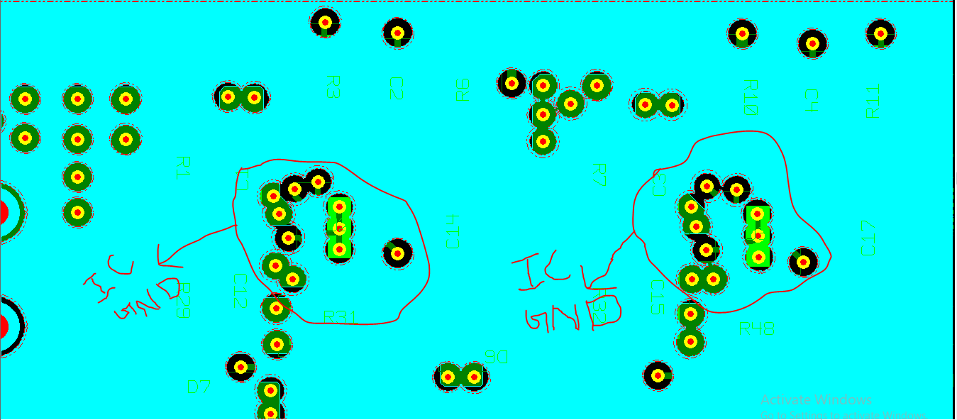

  • Hi Ashish,
    The layout could certainly be the issue with the board, as I was referring to the layout of your single LM27762 (not both of them together). Also like I mentioned before the LM27762 is not designed with current sharing in mind, so perhaps when you have run your tests at full load one of the charge-pumps might have drawn quite a large percentage of the total current and might have caused some damage thus in the following tests the other charge-pump might have had the same issue.
    When they are isolated, check if the voltage of the CP pin on both converters - it should be close to VIN. Also please check that FB- is with in specs (-1.22V) on both converters. A faster approach would be to change the ICs with new ones if you have them on-hand and keep their outputs isolated performing the tests at a lower current so that we could check if they can regulate the output on their own.
    Davor

  • Hi Ashish,
    Given your results, this seems like a layout problem to me. A particular issue with your layout is the placement of the Charge-Pump Output Capacitor (as far as i can see it is not even in the picture of the layout you sent), which according to the datasheet should be placed as close to the IC as possible and on the same layer as the IC. Like I posted before, I saw some other issues with the layout and more information on how to do a proper layout of the LM27762 can be found on page 17 of the datasheet.
    In any case, for your application that has an output current larger than the limit of the LM27762 I suggest not using this device in a current sharing configuration. What I could suggest is to use a buck converter in an inverting configuration just like our reference design: https://www.ti.com/tool/TIDA-01457. This will result in a easier layout and design, only 1 IC instead of 2 and also it uses significantly less external passive components.
    Davor

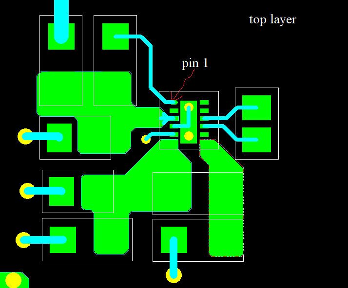

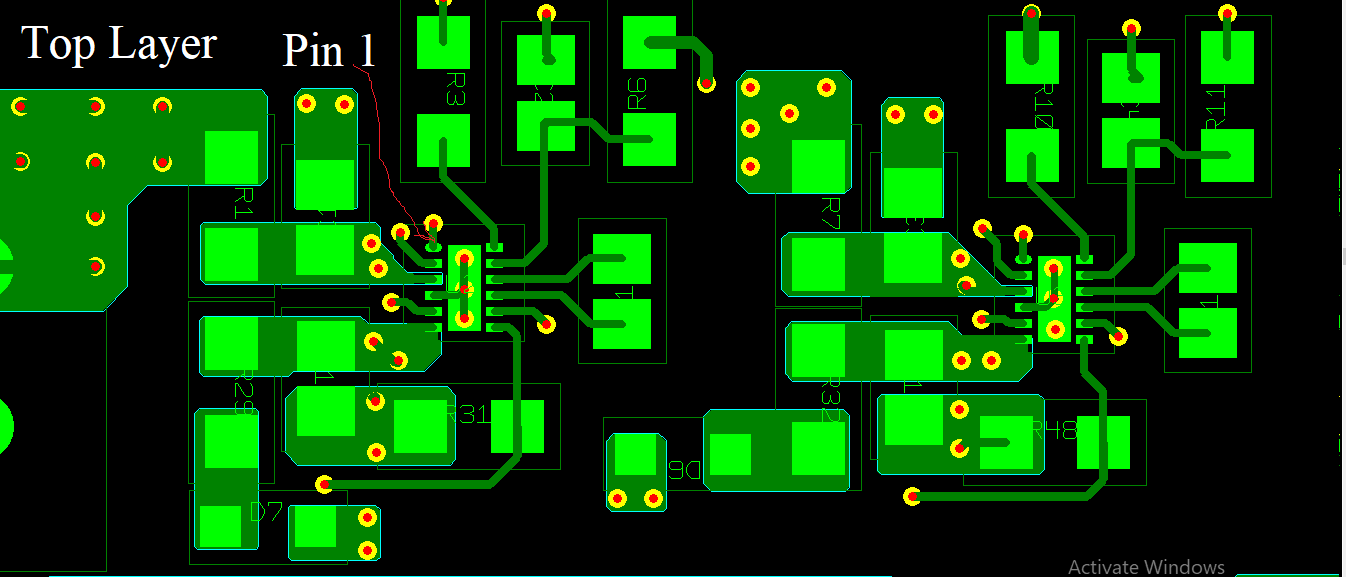

  • Hi Davor,
    As you are saying about that may be problem in my layout and as per the datasheet recommendation the CP capacitor place as close as possible to the ic and same layer.
    But my concern is that in my working board where I am getting proper output as per the calculation I also did the same layout.
    Here I am attaching my both working and non-working board layout.
    Please review this and let me know where I am doing wrong.

  • Hi Ashish,
    First of all, there are differences between the two layouts you have sent, I will just point out a few of the obvious ones:
    1. R3 and R4 are much closer to the IC and one of them is not routed through a via like in your non-working board
    2. The trace for Vout is larger on your working board
    3. The trace for FB- is larger on your working board
    There are some other differences but basically you are comparing 2 different layouts here. In any case our recommendations about the layout will always be according to the datasheet which I linked previously, that is why I will still say that placing the CP capacitor on the same layer with the IC is the better choice and following all other recommendations in the layout section of the datasheet (on page 17), as much as possible, is the best way forward for your design.
    I will also repeat the same thing I mentioned in the previous reply. The LM27762 is not designed with current sharing in mind, so a much better option would be for you to consider the reference design https://www.ti.com/tool/TIDA-01457 which is a buck converter in the inverting configuration.
