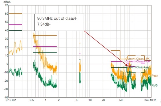

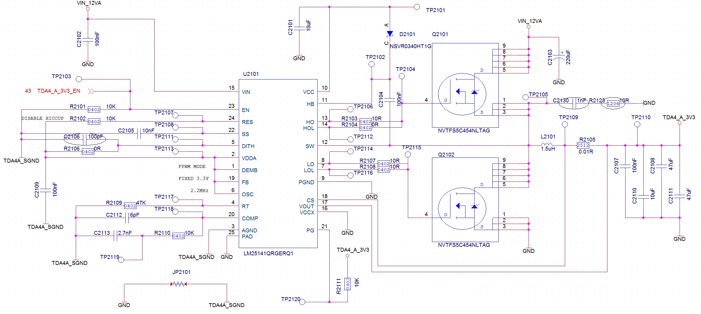

We use LM25141 as inlet power encountered EMI problems
The schematic diagram is as follows:

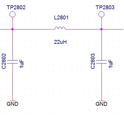

We have filter before VIN_12A:
Conducted emissions from components – current probe method test fail.
At present, the following methods are considered:
  1. We want to adjustment RHO,RHOL,RLO,RLOL,(R2103-R2108) , How to calculate the resistance value and maximum limit ?
  2. Enable Spread Spectrum, DITHpin connect 0.01uF to GND.
And those methods?
