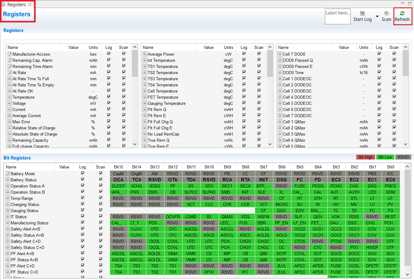

  • Go to the Register widows, take a screenshot of the bqStudio and share it with us?
    Andy
  • Register widows and screenshot of the bqStudio,Reply on Monday

  • The screenshot you provided is not what I am looking for.
    Please go to the Registers Window. See the screenshot below.
    Click the Refresh button and then take a screenshot of the entire window and share it with us.
