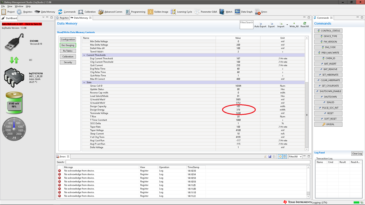

  • Hello Wyatt,
    I've turned the auto refresh off,  but that didn't help. the logs are still missing a lot of data.
    > I can see from the log that an OCV was taken but your SOC is still jumping. Can you confirm you have written the correct design capacity into the gauge?
    The studio shows the correct design parameters for my battery (see image)

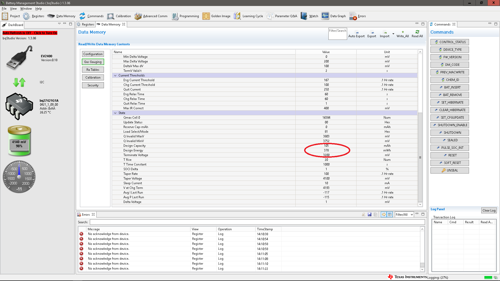

  • Hi again,
    here is the mentioned picture
