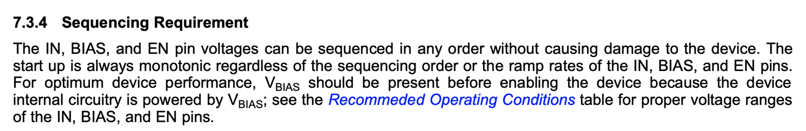

    2) Does it have a dependency on VIN, VBIAS and Cout? *The only dependency is COUT. see below from the datasheet:
    3) When we'd like to know the minimum time, how can we estimate the value? *Looking at the test data, the fastest startup time is ~460us and the slowest ~610us.
