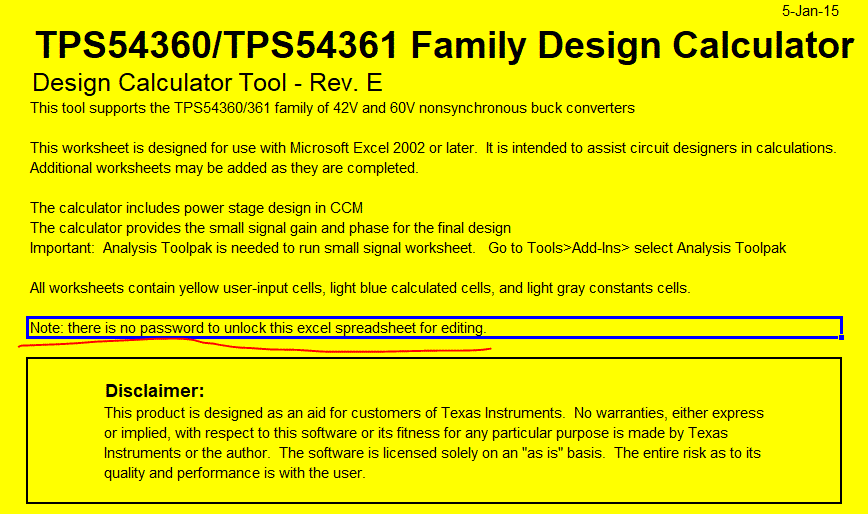

2) Can you send me an unlocked version of the Excel spreadsheet? I want to see the formula's used on the small signal tab. The data referenced in the plots does not show up. I assume it is hidden?

    2. As your answer gave no specific directions I had to work through this myself. True, the data sheet is not locked by password as you state, but this means it cannot be unlocked as you say it can be. It turns out it is not locked but 'protected' under the Format menu. Even then, the plot values don't show up in columns G through AA because the text color has been set to white. You need to change the text color to black to make them visible.

    2. in the excel, the Column G and AA is not pretected, only the text is use white color , if you change to red color, it will appeared.  I unhide the sheet and make them visible, pls let me know whether it is your want to see.
    Copy of TPS54360-361FAMILY_CALC_TOOL_REVE.xls

    2. the original author is not in our group, I don't know who generate this files, I can help check, but I am not sure whether he is in TI.

    1. Slope is 1A/V which is indicated in the excel
    2 there is no password.

    2. In my second post above I established the fact that the spreadsheet was not locked by a password and that the text color needed to be changed to become visible. I'm not certain why you are now telling me this again. The task for number two was to determine a) who the original author was and by extension b) who owns it now?
