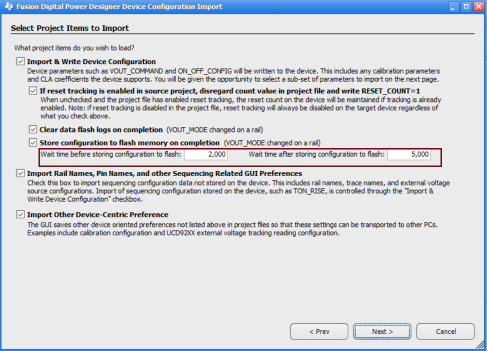

However when I go open the Configuration window in Fusion Digital Power Designer Software and try to download the config file using Menu File> Import to Device, I get the following error at the last step.

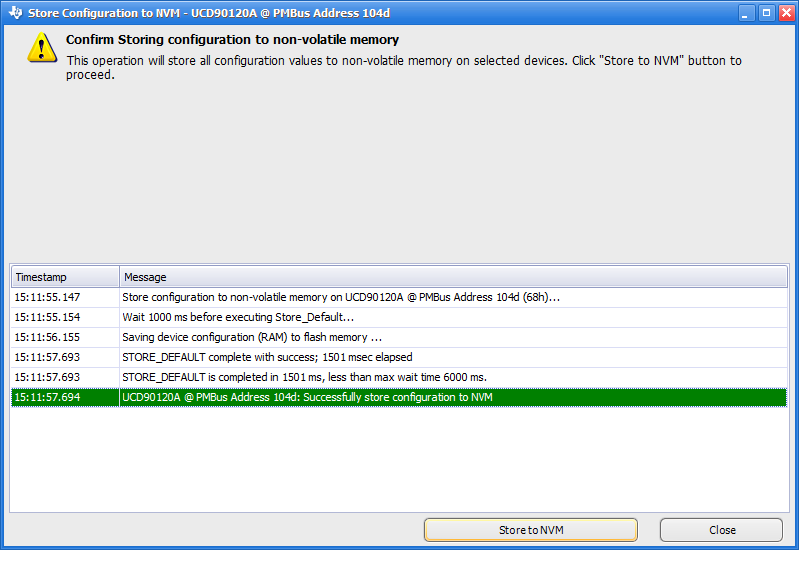

But when I try to download the config file using "Store to Flash" button , I get the following message with no error. But I don't trust this method, as it is inconsistent and it does not seem to flash to memory every time.
https://ticsc.service-now.com/sys_attachment.do?view=true&sys_id=6d92a194db29189056e4d7b2f3961909
I prefer to use the first method but it is not working. Any idea what going on?

    When I go open the Configuration window in Fusion Digital Power Designer Software and try to download the config file using Menu File> Import to Device, I get the following error at the last step.
  • Hello
    Both method are the same. you can adjust the delay based on the snapshot to fix the first method issue.

    Thanks! That did fix the issue.

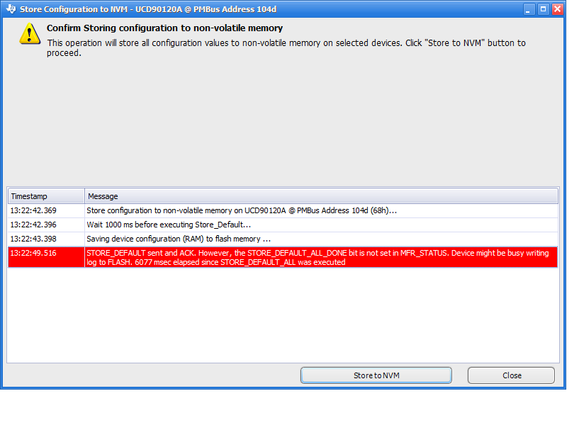

    One more issue.  There is one board where I am sseing the following error. I have tried to download the firm multiple times still no luck any idea?

    As for the particular error message , UCD90120A uses the same data flash for both user configuration and logging. But at any giving time, it can only do one thing. The message is to tell that  the flash is not ready for saving the configuration into flash. You can try it later.
