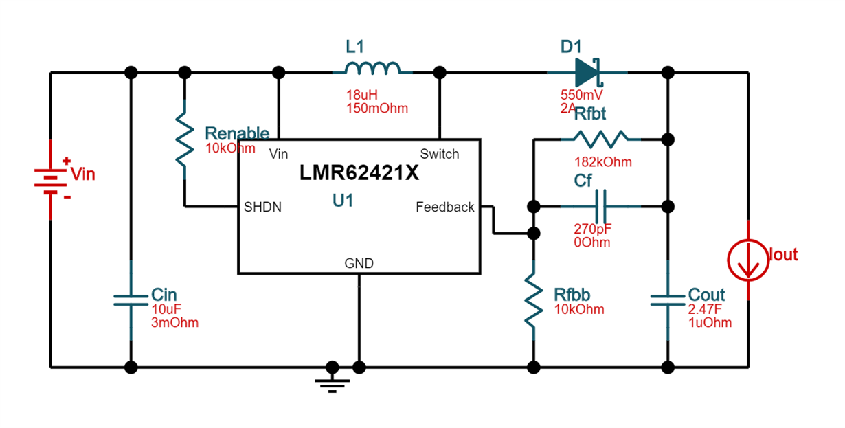

Hi I am trying to design step up power supply with 5V input 24V output with max current of 150mA. When I use Webench Power Designer it gives me a strange value of capacitance for Cout at 2.47F. I am not sure if its a bug or it actually expects me to use 2.47F capacitor. Could you please let me know if the output current of 150mA at 24V is possible with LMR62421 with input voltage of 5V.
