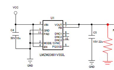

My customer is encountering LMZM23601's low efficiency and overheating.
I would be grateful if you could advise.
Regarding the board using LMZM23601V5SIL, the problem that efficiency becomes poor and temperature rises occurs on multiple boards.
Could you please let us know what's wrong and what makes it less efficient and overheating?
* The board has been confirmed by X-ray image that the Thermal Pad of the abnormal board is soldered.
*Even if the power of the abnormal board is turned on while continuing to cool the abnormal board with a cooling agent to about -10°C, the operation of the abnormal board will not change.
(There is no Thermal Pad VIA described in the data sheet, but we think that it is not a heat dissipation problem because the problematic operation occurs even if it is cooled.)
・Abnormal board
VCC 33V, Iin 107mA, Win 3.5W → VOUT 5V, Iout 54mA, Wout 0.27W: Efficiency 8%, LMZM package surface 47°C
VCC 33V, Iin 319mA, Win 10.5W → VOUT 5V, Iout 314mA, Wout 1.57W: Efficiency 15%, LMZM surface 200°C
(The temperature rises immediately after the power is turned on. Then ON: 100ms, OFF: 300ms are repeated)

・Schematic and image (same for abnormal and normal boards)
VCC=33V
Is there a possibility of unexpected connection with adjacent  pin, GND or VCC.
I appreciate your great help in advance.

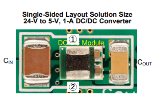

    • Probe the SW at light load to see switching operation during PFM condition. This can be done by probing the top side of the exposed inductor. Please be careful when probing the switch node. If SW is unintentionally shorted to GND somehow, the device will be permanently damaged. Doing this will help me understand if part is switching as expected.

    (3) I cannot understand how to confirm the waveform.
    Which is measurexd, Voltage or Current.
    The inductor current needs to use current probe.
    in this case the inductor has to remove and it is necessary to remove the inductor and modify it so that the current probe can be attached.
    When Voltage, should the probe simply touch the inductor?

  • Hi Shinichi,
    I should have been more clear. Please probe the SW node so I can see the voltage and switching period. This can easily be done by touching the top side of the inductor. Again be careful not to accidently short the SW to GND as this will damage the part.

    I understand it should be confirmed VSW.
    Which side should be probed with 1pin mark side(1) or the other(2).

  • Hi Shinichi,
    Please probe side "1" for the SW node of the inductor.
