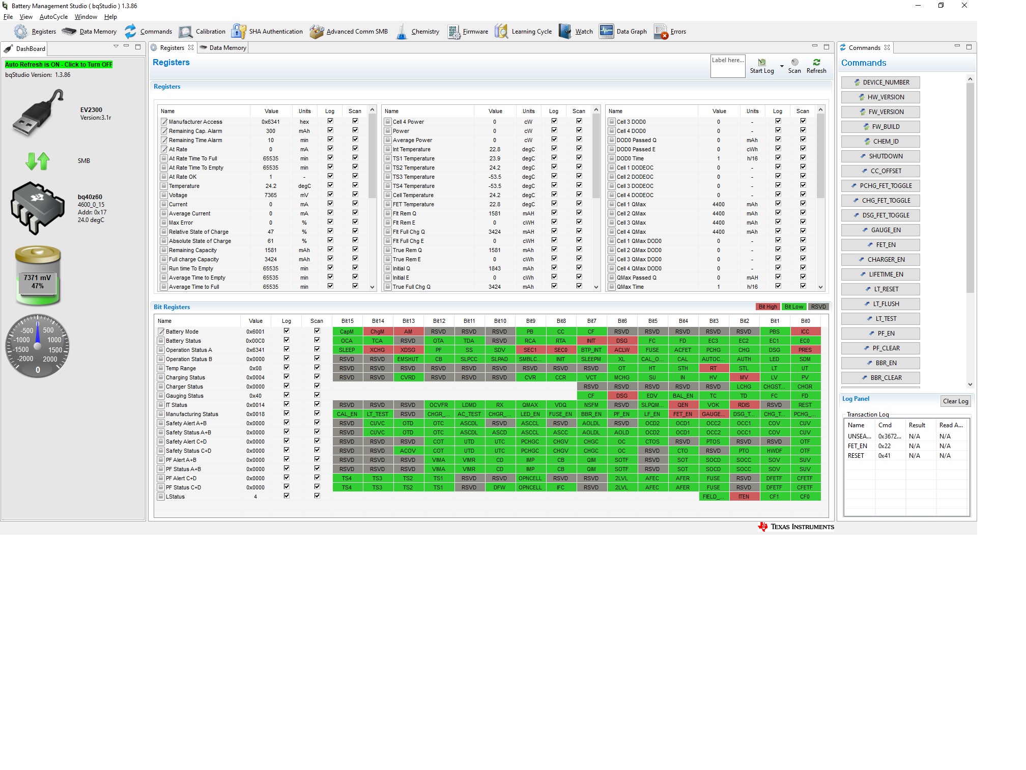

Dear Sirs.
I got my own PCB witch is very similar to the evaluation board (BQ40Z60EVM). I also managed to connect the EV2300 with the BQSTUDIO – works well.
My problem is the chip is always reporting 100% of the relative capacity. I think is because the learning process is not completed. When I start the learning procedure, the charging faze is finished immediately, even if the batteries are flat. It seems because of the voltage level, there is 4.2V at the plot, but I have 2 cells, so CC voltage should be 8,4, am I right?
Do you have any manual or video how to configure the BQ40Z60EVM board for 2 cells? Just step by step what to set to succeed.
I was able to turn on/off the charger/discharger so I think there is no any issue with my board.
Thanks in advance.
