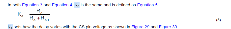

1.Datasheet contains a Chapter “Application and Implementation”. This chapter is an example of calculation of converter with numerical data for this particular converter. Formulas 151 and 154 in this chapter use parameters CS and KA, but I could not find any numerical value for these parameters, calculated or set before it have been used in these formulas.

    A1/ KA is defined in Eq 5
    CS in these equations is the the peak voltage at the CS pin.
