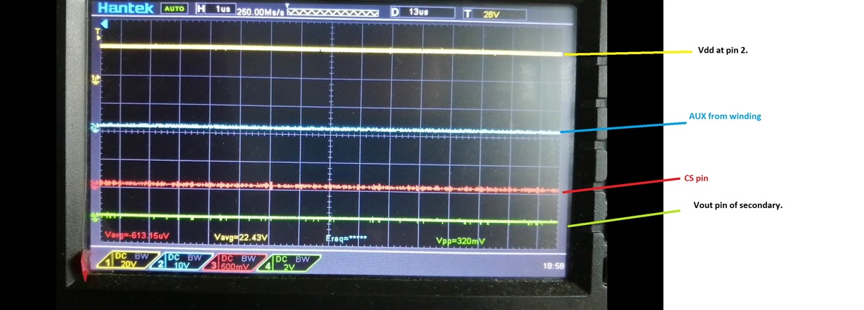

    Could you send oscilloscope plots of Aux, CS, VDD and VOUT during power it.  From these three signal you will be able to determine what fault is causing you not to startup.
    More than likely you are shutting down to an OVP caused by aux winding ringing.
    It appears that you are using a TVS clamp.  To dampen the ringing on the switch node you can do the following.
    1. Put a 1 nF capacitor and a 511 k ohm resistor in parallel with Dz.
    2. You could also add a snubber across D2 if you need to dampen the ringing further.
  • Hello Mike
    Thank you for your reply. Follow your instruction, I captured the oscilloscope wave shown below for your help to verify and to better understand I also attached photo of my PCB currently using. Some wire jumps due to diagram error.
    The wave didn't change at all.  https://youtu.be/krVsl0vSYjM
