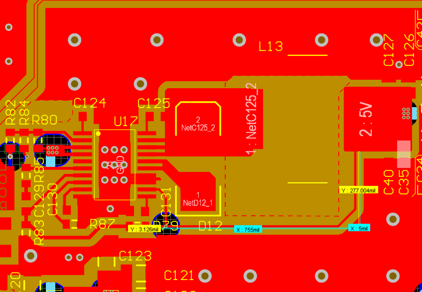

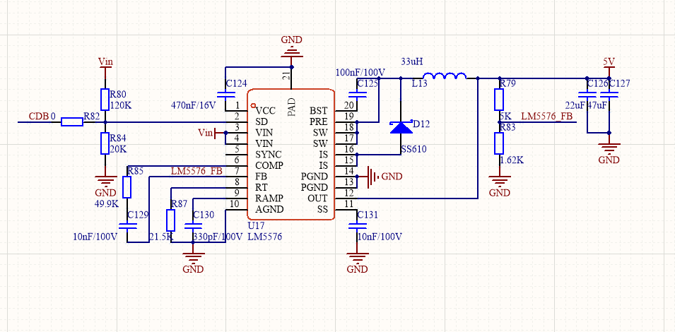

LM5576 temperature is too high (160°F)。
Is there any problem with the design?

2. one thing you need to change is I don't see any input cap on your board or schematic which is close to the chip, the input cap is used to provide energy and reduce the parasitic inductor of input wire. and you need put the ceramic cap close the Vin and GND of the chip

2. C121 and C123 are my input cap. (44 uF).

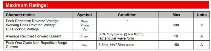

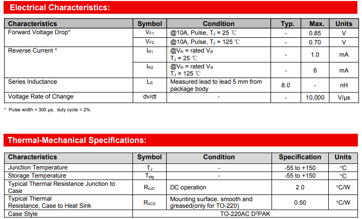

for replacing diode,
you need the diode have smaller voltage drop at same Io and make it has good way to dissipate its power loss by optimize the layout.

you may compare the 2A voltage drop with old diode, if it is smaller, it will have less power loss.
and I think your PCB copper for diode thermal is not enough, maybe use more copper will help.
