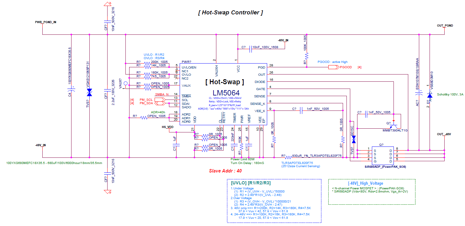

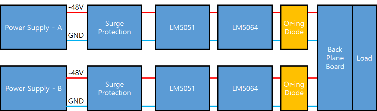

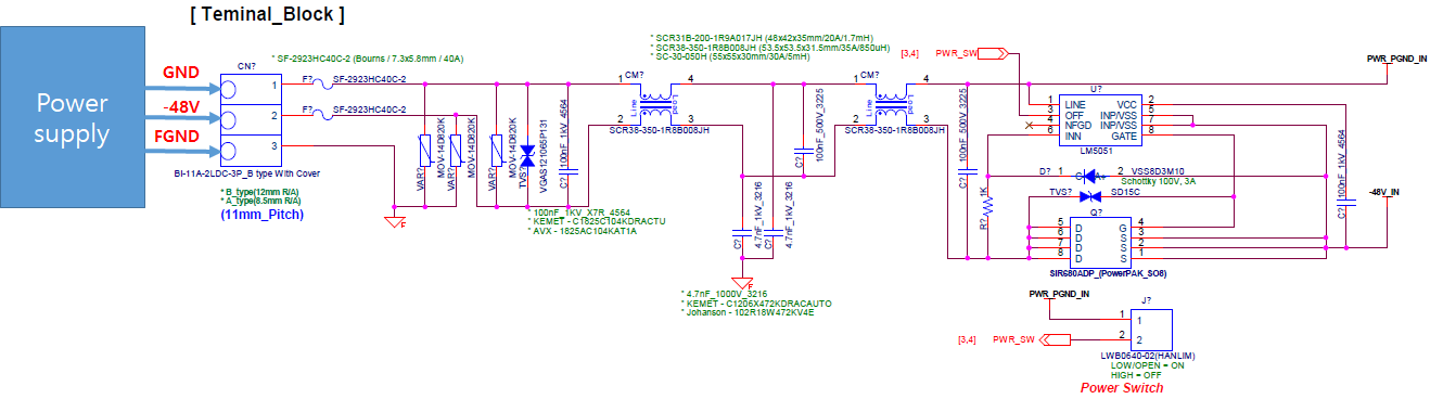

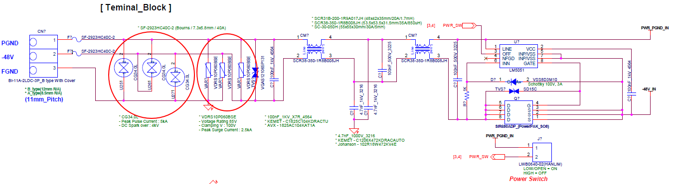

The circuit was configured as above using the LM5051.
The power we need is -48V, 30A.
I want to design so that no interruption occurs during the 4kV surge test, but I want to know if the design of the front of the LM5051 is done properly.
Is there anything to reinforce? It is very difficult because it is the first power design.
After the above circuit, hotswap is configured using LM5064.
