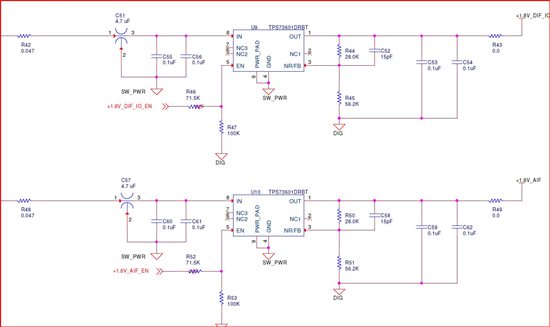

I have several TPS73601DRBT parts in an application that (should) output 1.8V and were considerably lower.  It seems the references are varying from 1.106 to 1.110 V.  When I changed the divider values to correct for this very low reference voltage the output voltage is as expected. Input voltage is 2.2725 V (measured.)  The feedback divider current is right at 40 microamps.
I've stuffed a half dozen parts and this really has me worried as I'm risking high cost parts downstream if this doesn't work correctly.

    I'll be able to as soon as I cut and paste the image, but it's essentially the datasheet schematic and parts list..

  • I should also mention that only one of the two input and output bypasses are stuffed.  I left some slots for troubleshooting and optimization.

  • We may have just found the problem.  At least we found a major problem.  The feedback loop and power ground were referenced to two different power planes that were ~200 mV apart.  Not intended, but it crept in.
    What is "not optimal" about the layouts? (You, know, beyond the fact we messed up the grounds. )
  • Recommendations for the layout would be to connect input capacitors with short wide traces between Vin and GND.  I would also connect them without vias.  You can connect the ground side of the capacitors to the thermal pad which is connected to GND.  I'm glad to hear that you were able to find the problem.  I'll close out this thread.  Please let us know if you have additonal questions by opening another thread.
