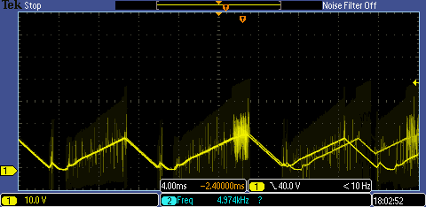

We use lm3481 in a project. sepic converter, we have done R&D with 3478 before, but the soft star did not get up. We switched to lm3481. Now, we want to limit it to 1 amp for example.
In 3478, the situation is smooth, the output voltage drops regularly down to 28 volts.
but at 3481 blow gap occurs, the output comes to the triangular wave. There is an interpretation in the sense of enlarge r sense for a similar problem, but is there anybody who can help?
do we have another problem?
sometimes the sepic capacitor is sometimes burning mosfet in this unstable state
