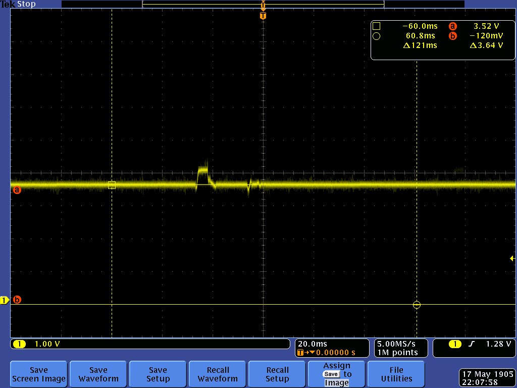

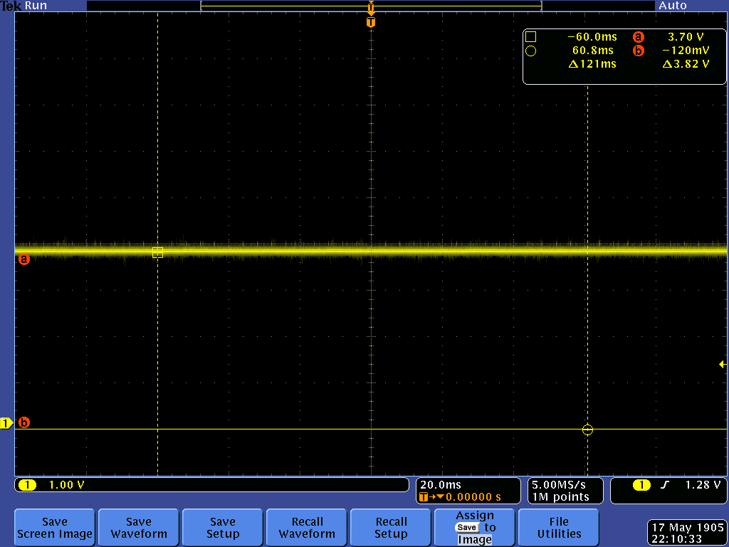

We have been using the BQ24193 battery charger for a couple of revision of our system and we've noticed a change in behavior where if the battery is almost depleted, the charger starts pulsing from 3.5V to 4.0V. This is not seen when the battery is full.
What could cause the pulsing to occur? I've attached a couple of scope images below.
Supply voltage is at 13V. We programmed the charger to have an input current limit of 500mA.

Battery charger output with full battery:
Battery charger output with low battery:
    1. What is the battery voltage you referred as "the battery is almost depleted"?
    2.  You mentioned "the charger starts pulsing from 3.5V to 4.0V", which output are you referring to? VSYS or VBAT or something else? Is the pulsing one time or repetitive?
    Ning.
  • Good morning,
    1)  When out battery is fully charged, it outputs about 4.1V. A low battery for our system outputs about 3.4V.
    2) The output I am referring to is the Vsys output. The pulse occurs repetitively. At just about 2 Hz.

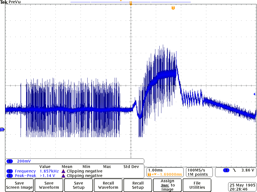

  • Here are some more updates,
    On the scope capture below, you can see a zoomed in transition of the charger output on the SYS pins during the increase in voltage.
    The noise surrounding this is actually seen on the ground plane as well. The top line is connected to ground.
