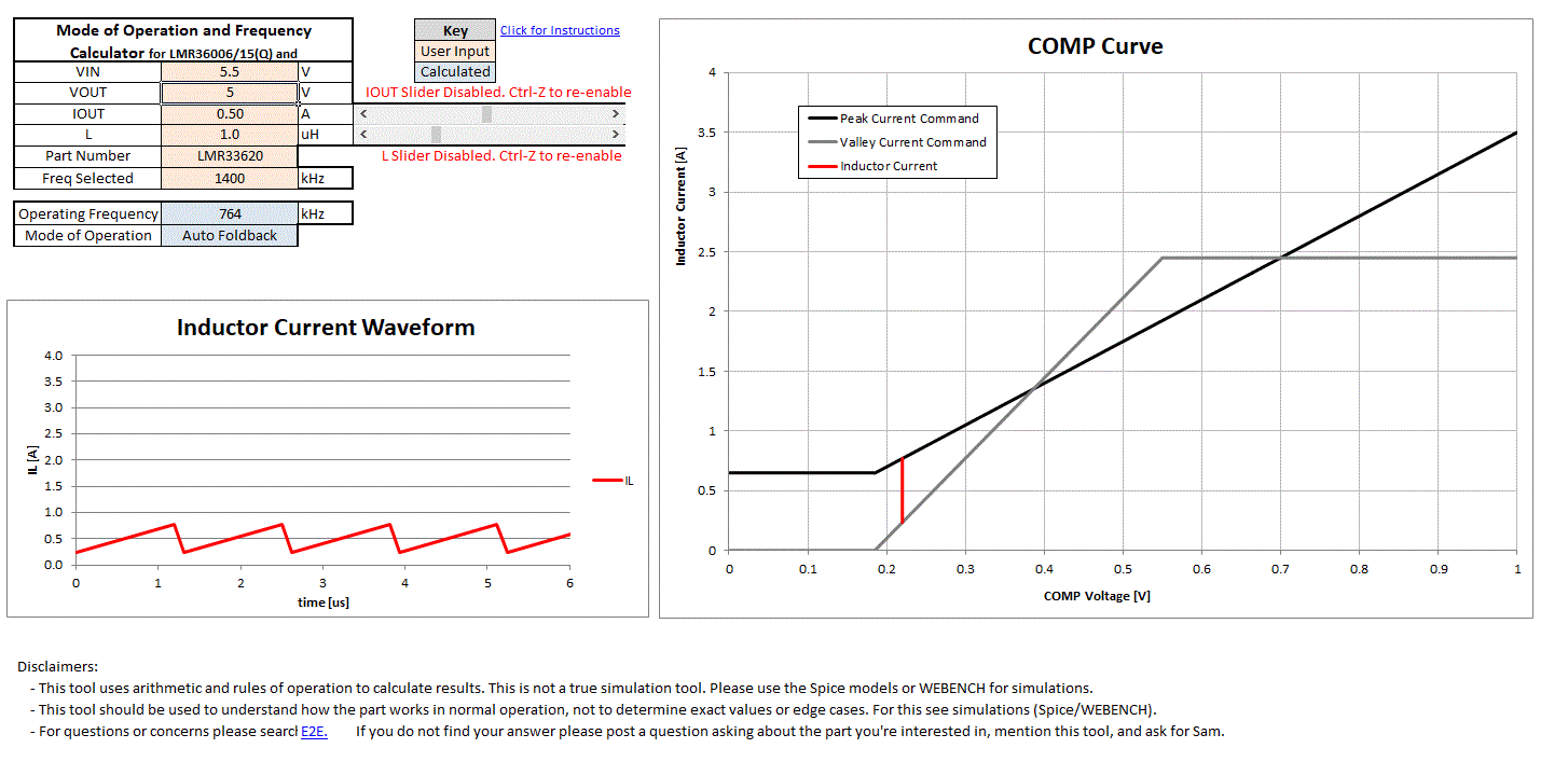

Hi team.
I'd like to know about the max duty cycle.
According to the datasheet, it is written 98%(TYP).
However, the minimum switch off-time does not fit the calculation.
I want to use B version(1.4MHz) and RNX PKG.
My condition is bellow.
Vin=5.5V, Vout=5V/0.5A
Duty is 91% in my condition.(=5V/5.5V)
So, On-time is 65uS and Off-time is 64.9nS.
The minimum switch off-time need 70nS(MAX) from the datasheet.
Is it not possible to use under these conditions?
