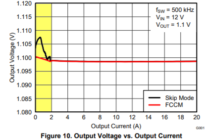

We want to check why the load regulation curve is like this.0-2A, the load regulation change a lot, but it keep stable after the current above 2A. (Even the FCCM mode)Thanks.

Because the TPS53353 uses D-CAP mode control with valley voltage regulation, as the inductor current becomes negative during the high-side FET "OFF" time the relationship between the internal ON time and the external SW voltage on-time changes as the negative inductor current drives the SW voltage high during the dead-time, the peak to peak ripple increases at light load, even in FCCM so we see a small rise in the output voltage as part crosses the critical conduction boundry.
This is much more pronounced in Auto-skip mode as more and more of the inductor ripple current is greater than the average load current.
