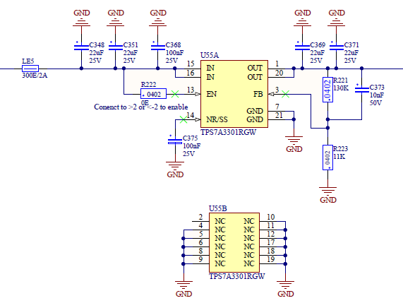

Below is a screenshot of the negative LDO schematic:
We think the output transistor is damaged as we are still able to measure a voltage on the NR pin of the TPS7A3301. The rail is probably pulled positive through the opamp supply pins to the positive supply rail. We have a BAV99 diode on the output of every LDO, which is why it is clamped to only 0.8V.

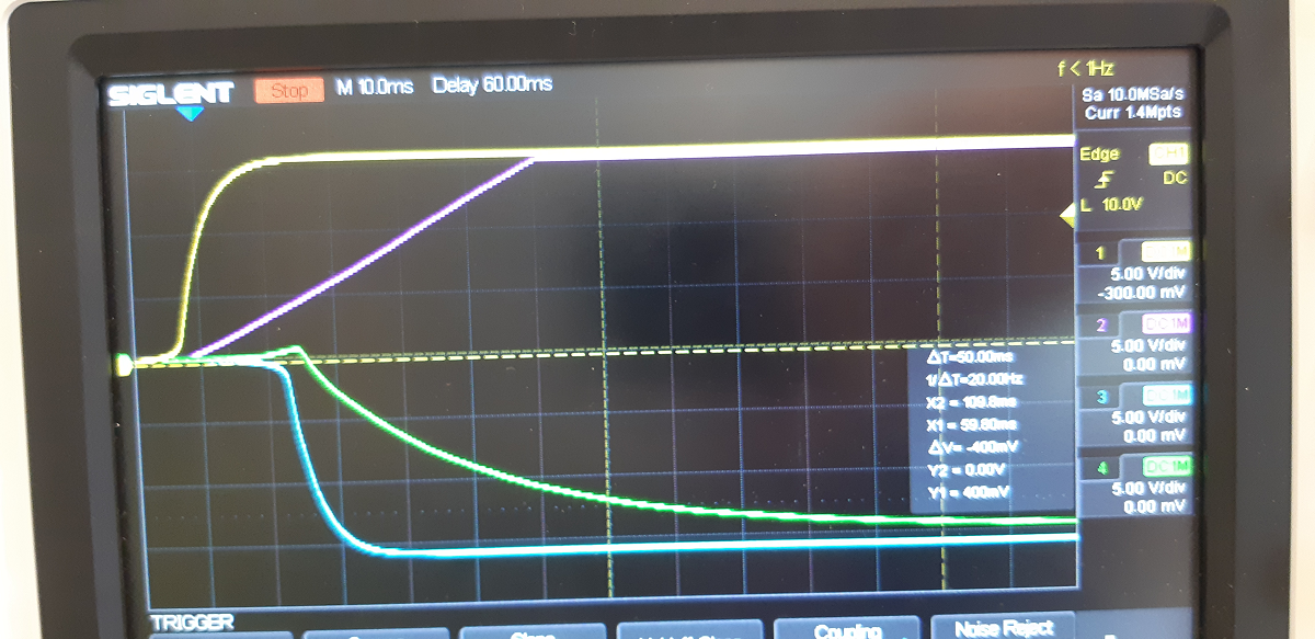

We think the damage might be caused by a positive supply voltage on the output of the LDO during startup. A screenshot of the startup transients of one working set of 15V rails is shown below. 16V in in pink, 15V out in pink, -16V in in blue and -15V out in green. This is taken when powered by a dual bench power supply (one board failed under this condition). We see the negative rail going slightly positive (about 0.7V) at startup which is above the 0.3V absolute maximum rating of the TPS7A3301 output.

  • Hi Carlo,
    The startup could be damaging the device. Is it possible to measure the current into the device during this event? With the output clamped to ~0.8V, it suggests the device has been damaged. Can you contact your local sales to get them to help send the failed devices in for failure analysis?

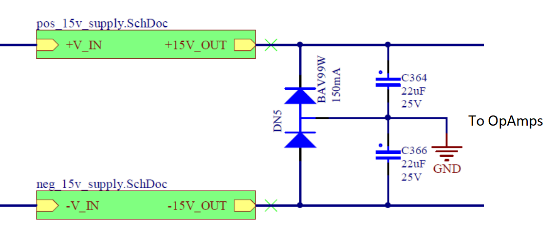

    The output is clamped to ~0.8V due to the clamping circuit external to the device. This circuit is shown in the figure below. When we lift the pins of the BAV99 diode, we see the voltage rise a bit more to about 1.3V.

  • Hi Carlo,
    The best recommendation to mitigate this is to make sure both the positive and negative rails are up before enabling both of the LDOs'.
    And indirect means of doing this might be to use something like the TPS3840 to detect the positive input relay is up and set a reasonable delay to enable both regulators simultaneously.
    A direct means to ensure both the positive and negative input rails are up before enabling the +/- regulators might be to use the TPS38600.
    Do you think either of these approaches would work for you? I will forward this to our sales team to see if they can reach out to you for FA analysis.
