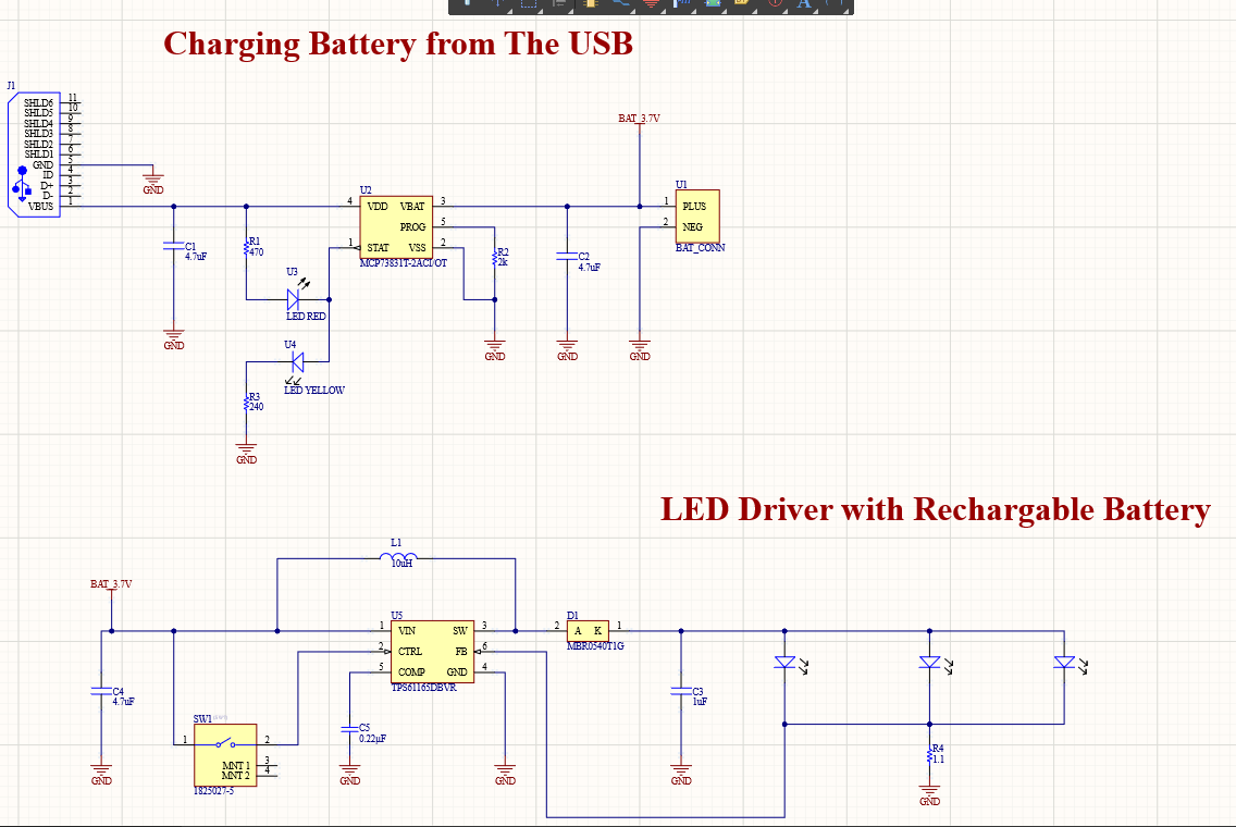

TPS61165: Rechargable Battery Powered LED Driver with TPS61165
Part Number: TPS61165
I want to design a led driver system with a rechargable battery (3.7V) powered with USB chargable. The led driver system was designed with TPS61165DBVR, and I plan to use 5-7V forward voltage and 20mA forward current LEDs. I placed a tactile spst switch on the power line and the led driver will operate when I press the button. My question is that is the design true for driving these type of leds?
Thank you
