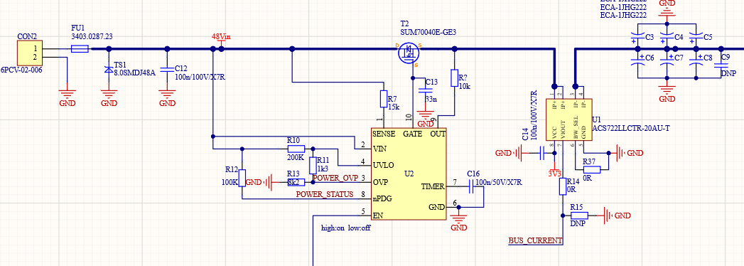

Good morning to E2E,
I would like to ask you for some help. I have new project for our customer, where high capacity (15 000uF) load is switched to 48VDC. The application is an Power Controller Board 48VDC / 1kW. To switch on the power line, i'm using the LM5060 with N-FET SUM70040E. The problem is, that the FET burns after switch on, and also LM5060 is not functional anymore.
Schematic is default from the datasheet, and values are calculated using the LM5060 Design_Calculator_REV_C.xlsx
Can You plese give me some advice, whats wrong ?
