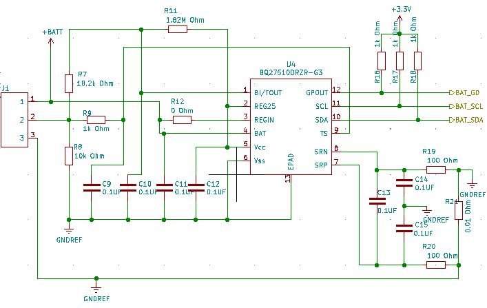

Hi Team,
Our circuit is similar to the one in typical application of BQ27510DRZR-G3 except 10K ohm resistor added between J1-2 and decoupling capacitor C1. If thermistor is not used in Battery pack, together with R2,R3 and 10K ohm, Ts will receive wrong value. How to correct it?
